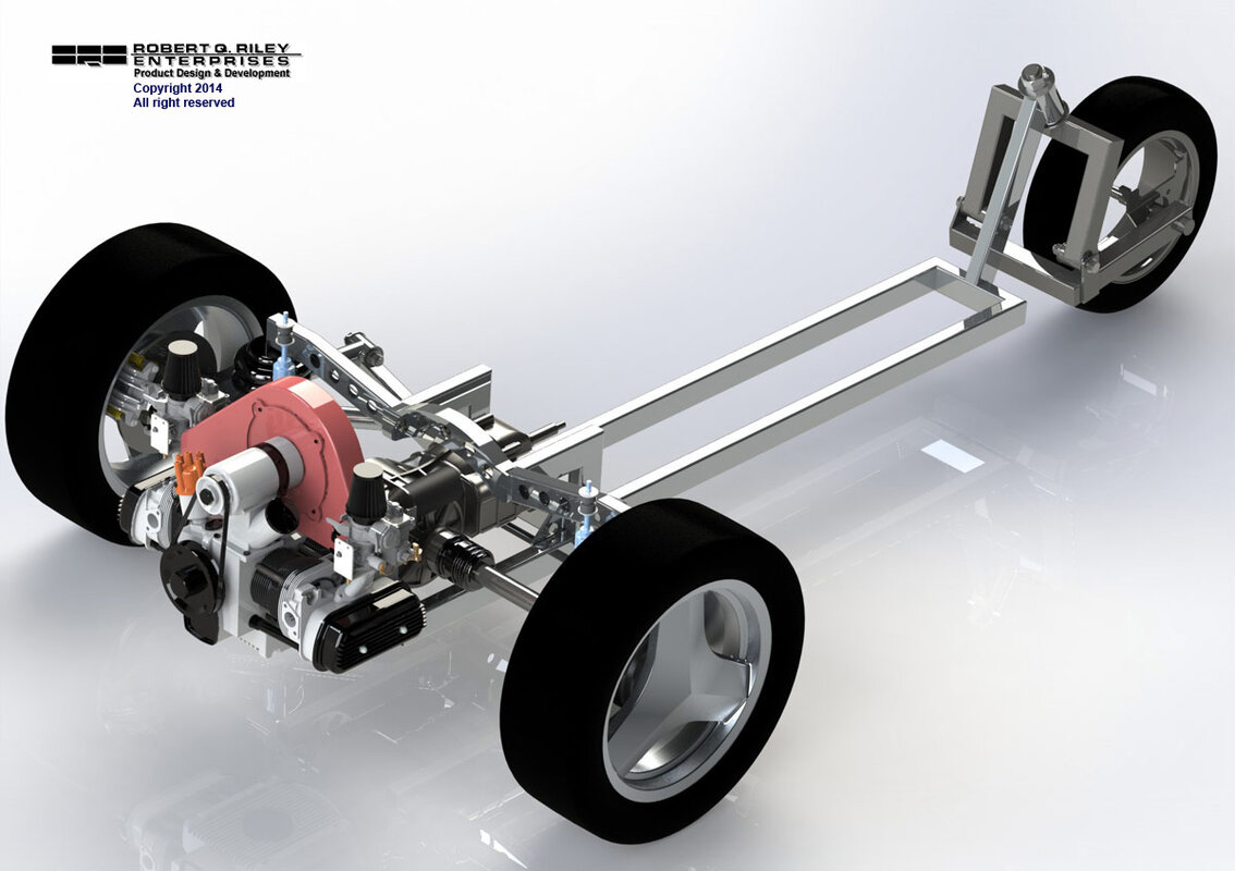

I'm planning to use a variation of Robert Q. Riley's Trimuter design - it's a lot simpler than an Earl's and the top of it can be a lot lower.
Here's a pic:
I'll be using a round tube for the crosspiece right under the neck because it's easier to drill at an angle in round. For a spindle/brake, I'm going to try a Super Beetle - same wheel bolt pattern as my rear wheels so all three can match (from the driver's side at least).
If anyone's built one, or has the plans, I'd like to ask some questions.
