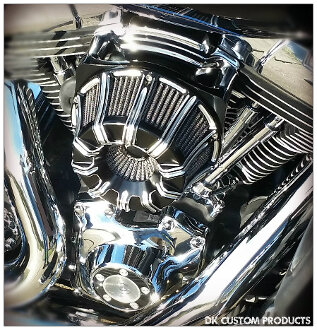

We have hundreds of Customers running the AN BS with our External Breather Systems.<br />
<br />
Most are using one of the <a href="http://www.dkcustomproducts.com/All-Twin-Cam-Engines_c76.htm" target="_blank">DIY Head Breather Systems</a>.<br />
<br />
Even though running at the correct oil level (midway on the dipstick), there is still oil and hot oxygen depleted air going into the intake. This results in lower performance, lower mpg, tune instability, and the inside of the engine looking like this-<br />

<img src="http://www.dkcustomproducts.com/media/TwinCam1M3.jpg" border="0" alt="" /><br />
