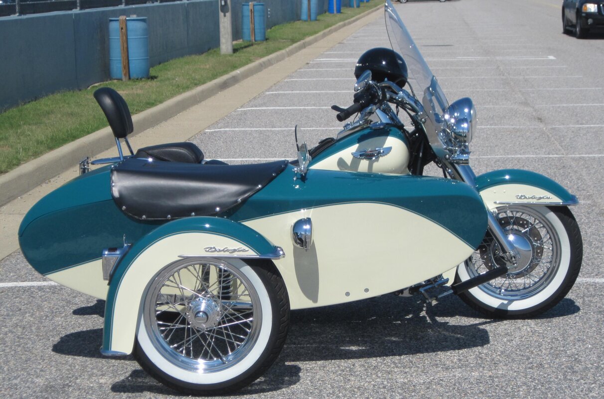

I rode my 09 HD Deluxe from VA Beach VA to Sibley IA to have my sidecar installed at the Motorvation factory. Then I rode the rig back to VA Beach VA (1795 miles one way). Talk about Iron Butt... The ride back was fine once I realized that the rig was going to pull to the right or left depending on the crown of the road. I actually stopped at a HD dealer in Memphis to have the rig adjusted because it was pulling to the right too much. The ride back wasn't bad at all. I did put a 50 pound weight in the floorboard of the sidecar to keep it from flying the wheel when I'd take freeway exits too fast (all of the time..:)). One thing I also did before starting out on my journey was upgrade the front springs. I had easy duty progressive springs put in the front tubes. I've attached a picture of what my rig looked like (I've sold it since then).

Sweet looking rig ... love the colors ... very retro.
