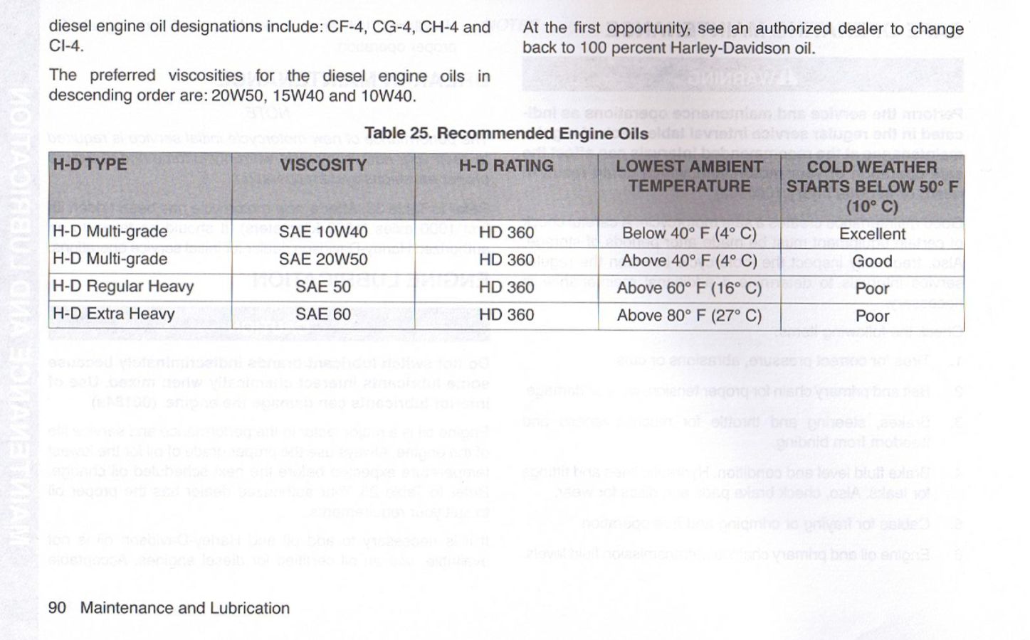

Just moved from Jersey to the Tampa area. Used to run Red Line 20W50 synthetic in Jersey and wondered if I should switch to 20W60 now that I’m in FLorida. Riding a 2021 Tri Glide.
20-50 is really a misnomer. It is 20 weight oil with modifiers to make it behave like 50 weight when hot, that does not hold up good especially with dino oils.
Stick with a name brand full synthetic ( not HD Syn3) Not a true full synthetic oil
Best yet if you trust a full synthetic 50 weight like Royal Purple or Redline you will be miles ahead. JMO
What Jack Said.
Here's a vid where the subject is discussed some-
Just moved from Jersey to the Tampa area. Used to run Red Line 20W50 synthetic in Jersey and wondered if I should switch to 20W60 now that I’m in Florida. Riding a 2021 Tri Glide.
I'll assume you have been happy with using Red Line 20W50 synthetic so I would stick with it.
I've lived in Lee County FL and now up in Polk County (a little south east of Tampa). I have experienced some overnight temps here in the low 30's. Also have had a handful of days in the low 50's. Then of course you have a ton of extremely hot days in the summer.
Here is how I look at it, my riding temperature range is still about the same as when I lived up north, 60's to 90's. If it is below around 65 I don't ride, if it is high 90's or over 100 I don't ride. I just never felt the need to change when I moved down here.
