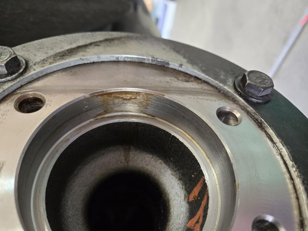

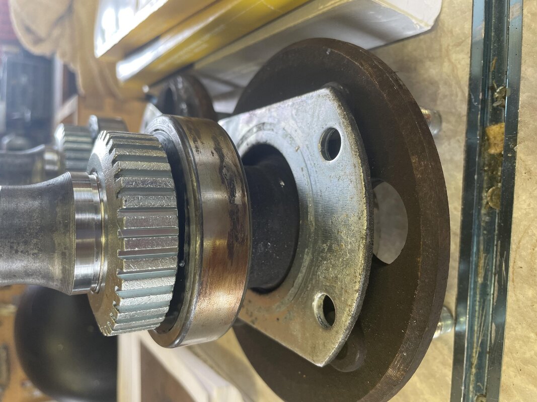

Bored yesterday morning so I decided that I would pull axles now instead of waiting for winter. Here is a picture of R/H retainer plate and bearing. This is at 24,800 miles. Obviously should have replaced the retainer plate with the DK version earlier. Pulling the axles was quite simple however getting the bearings off the axles has turned into quite a tug-of-war. I've got a 20-ton arbor press but it isn't budging these puppies. Going to take the axles over to the local John Deere dealer later today and see if they will be willing to give it a go with their shop presses. Order the new parts yesterday (Thursday) from DK and they are supposed to arrive next Tuesday. Looking forward to getting this fixed and back on the road.

All finished with the replacement. Real easy to do once the bearings & tone rings were pressed off. John Deere wanted nothing to do with pressing them off since it wasn’t a green color :) Took axles to an auto repair shop and they had a 50-ton press. Popped them right off. I pressed new bearings on and reused the same tone rings. DK plates are not going to warp.

I took my axles to an automotive machine shop and had the bearings pressed off and new bearings pressed on with the DK plates. When I put the old plates on a surface plate they were definitely warped. After only 25,000 miles. Bearings were good retainer plates were scored and warped.
