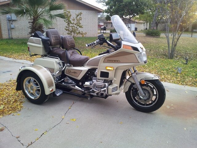

At a rally this year we did some serious riding a little over 1000 miles in 2 days in the Texas hill country, the three twisted sisters and several other back highways. I not only was keeping up with the pack in several cases I was running them down and had to back off.
Vern
