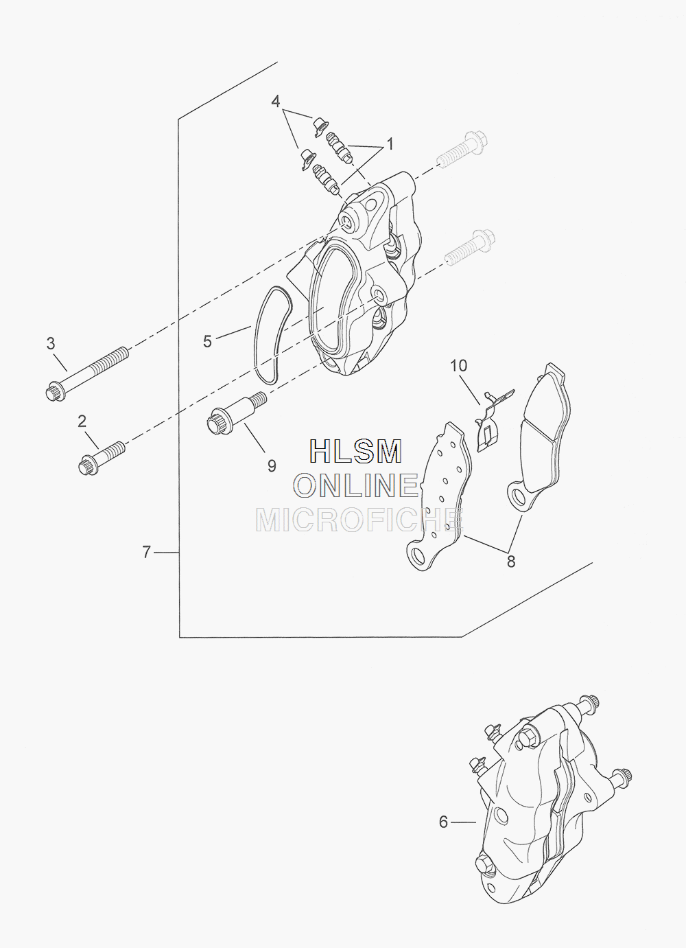

Just start in the front left, then front right. Those are the most forward bleed screws on the Freewheeler caliper.
The 2 aft bleed screws on the front calipers are for the rear master cylinder. Then you move to the rear wheels.
