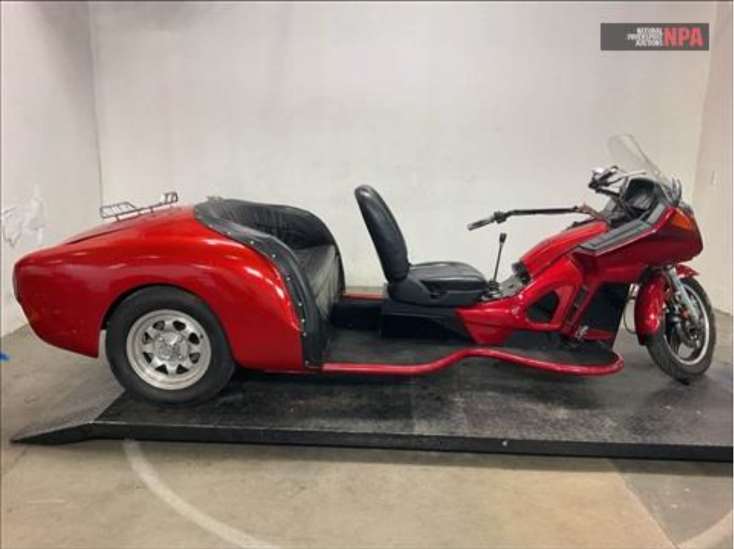

A while back I posted pics of the trike below during its 4 year build. It has been on the road now for the last 2 years and I am loving it.
Here's what I just got done with...

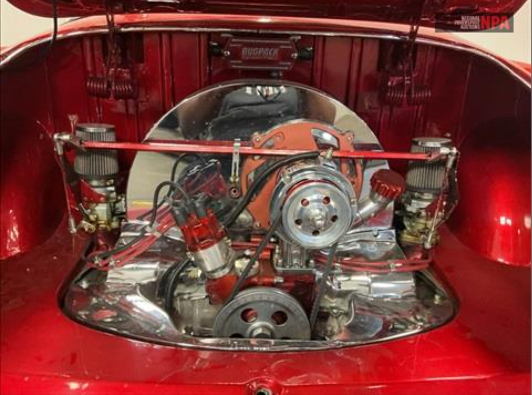

top of the frame is Honda GL1100 as well as the forks, front wheel and handlebar assembly. The rest is hand built. 1776 engine, side draft CV40 from a Harley (modified) under the seat. It runs great, is fun, is stable and reliable. The fan on the oil cooler is set to come on @ 180 degrees oil temp on the outlet back to the motor and rarely comes on. Some heat off the engine @ stop lights in hot weather but none going down the road.
Looking to build a leading link fork and figure to mount a car tire on the front once I get the trail right.DSCN5644.JPGDSCN5643.JPGDSCN5642.JPGDSCN5641.JPG

That is a very sweet looking mid engine VW trike. Very clean and great lines.
Have you got any pictures of the side draft carb and how you set it up and what not? That would be great information for the VW trike forum.
