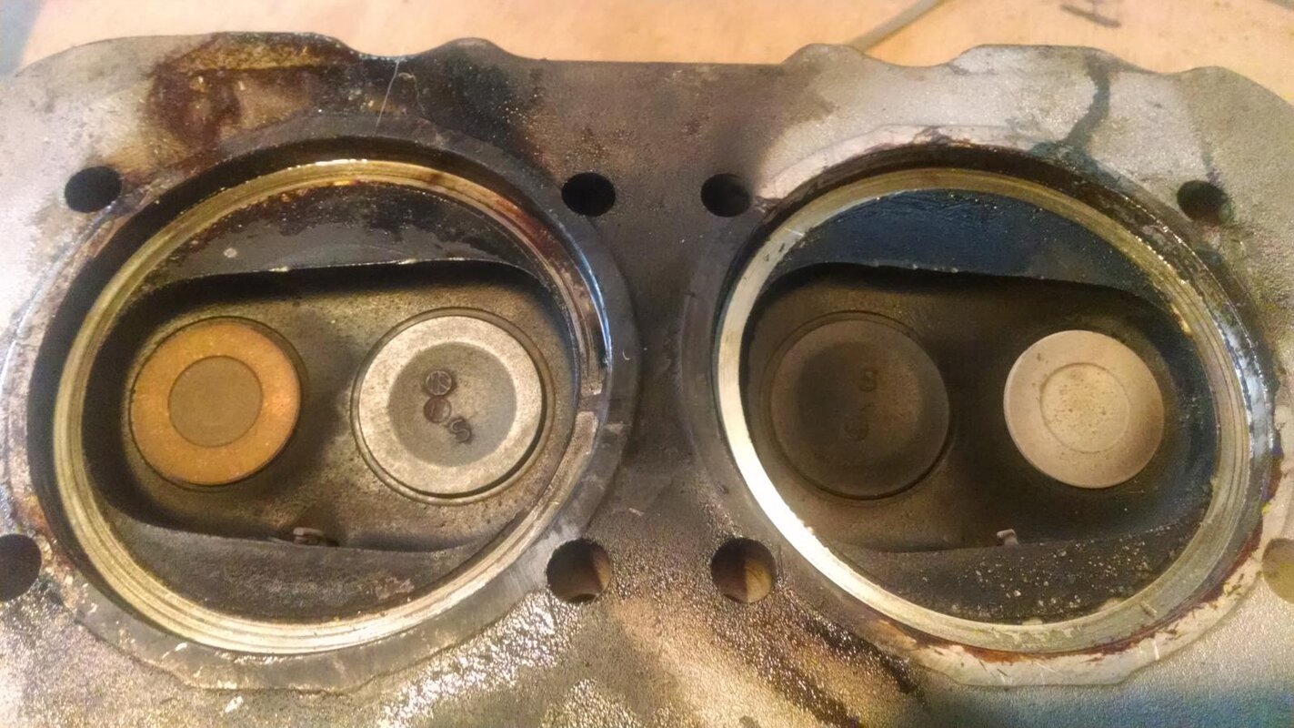

Can you tell I've never been inside a vw engine? :D I searched the web stores for new head gaskets to have on hand when changing push rod tubes with no luck, then read somewhere that no head gaskets are used,,,ok,,cool. Sooo, what's the deal, just clean both sides and re-install? I'll also measure bore/stroke to verify engine size while heads are off. I'm guessing it would be a good time to check valve seats? Thanks
No head gaskets are used........Its a medal to medal fit........Clean both sides but ''Do not scuff''....

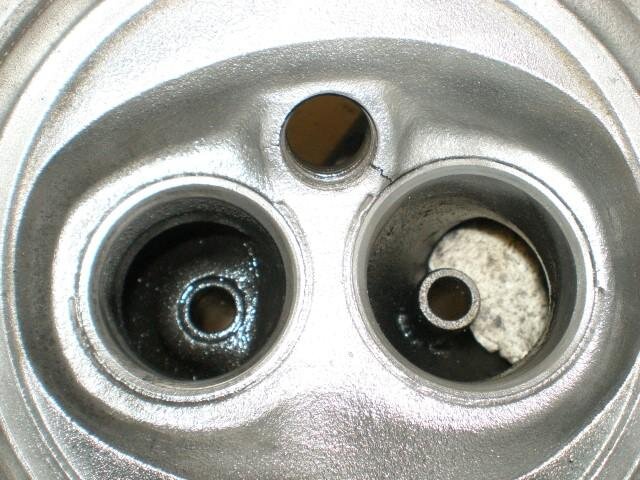

Here's 2 things to look for when heads are off:
1. Cracks between spark plug hole and valve port (common) or between intake and exhaust ports (less common).
2. evidence of compression leakage between head and jug. This picture is extreme. Usually discoloration and slight roughness at mating surfaces. This is caused by loose heads. usually indicative of head studs pulling out of cases. VW recommends checking head torque on a regular basis. This is also a picture of an extreme case.
Remember these engines are getting long in the tooth and fatigue is taking it's toll.
Good tips. If the heads are coming off you might as well service them. If you have extreme compression leakage you can get the head surface fly cut. Light blowby can be fixed by lapping the jug against the head. If you have an old big-stud case you can have case inserts installed to stop the studs from pulling. Replacement cases already have this done.

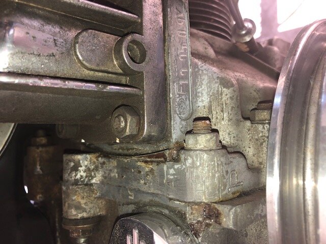

Also, checked the case number, "F 10 05 09X" The info I found said it was a 1300, trike title says 1969. Piston size and stroke says 1600.
A 1300 is an H case.
Dont know what a F case is....not in the list.
Are you sure there is not an A in front of that? That would be a 1600 single port.
Usually an extra stamped at the end like that X, means a remanufactured engine.
Some remanufactured ones are re-stamped with a complete NON VW numbers.
Is it a dual relief case?
Dog house oil cooler?
It is entirely possible that you were sent some extra long stroker motor tubes by mistake.
Finally got a pic up, just gotta turn your head sideways. It's a dual relief case. Also I noticed the "re-manufactured" stamp before the numbers, and there's a A and P where the case splits.
Aircooled website says 7 1/2" tubes for 1300-1600,,, and 7 1/16 for 1200.. Don't know why but my engine/heads took the shorter 7 1/16.
Yep.
Original number has been machined off and a different number stamped.
But if it is dual relief....then it is the latter 1600 case.
But if the other tubes fit and work.....then that is all that matters.
As a side note.....
Replacement engines used to not have the serial number stamped.
The installer was supposed to stamp the original engine number onto the replacement.
So there are lots of engines out there with 1200 or other older serial numbers stamped into newer replacement 1600's.
For instance....my case was not stamped, the DMV wanted the number transferred onto it......soooooo my engine serial number is a 1985 gl1200 Honda like my fork neck. So as far as the DMV cares it is a numbers matching 85 wing with a trike conversion.
