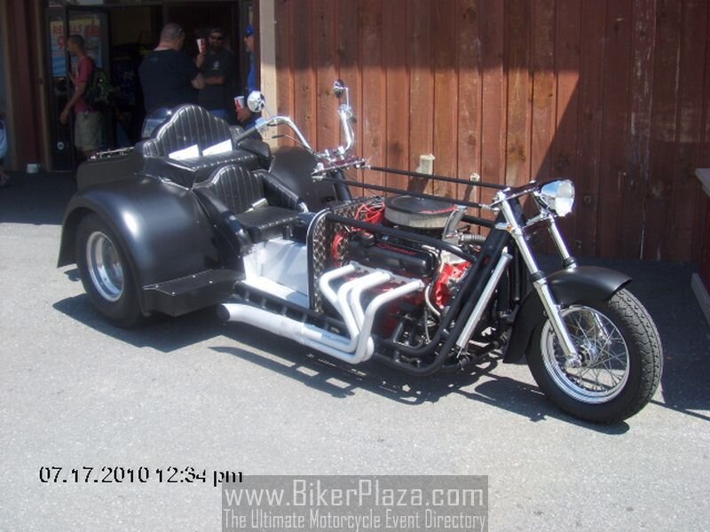

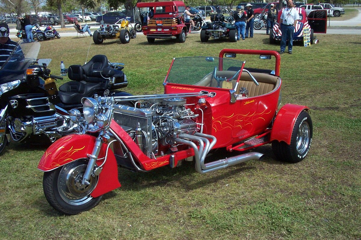

I am asking for any trikers who have built
any trikes with "Push-Pull" steering to give me their insights about that type of steering---
Or anyone who has a thought about this type of steering.
In Push-Pull steering, there are 2 bars that the steering rods connect to...
A FRONT bar on the forks and a REAR bar that is around the handlebars.
Here is the question:
1--How is the steering changed if the FRONT bar is made longer?
2--How is the steering changed if the REAR bar is made longer?
3--How is the steering changed if BOTH bars are made longer?
Basically, is the steering made easier if 1 bar is made longer (Either one) or is it made easier if BOTH bars are made longer?
Thank you.

I would think it should work like pulleys or sprockets. A shorter bar at the handlebars would make the handlebars easier to turn but you would have to turn the handlebars farther to make the fork turn. A shorter bar at the fork would mean that the fork would move quicker or more when turning the handlebars but, would make turning quicker and harder. I hope this makes sense and, that I understood your question correctly.
Short bar on the handlebars equates to easier steering however it will have less travel. The farther you go from the pivot point the more travel you will have however you will have less strength. Cheers, caveman
A: Steering would require more strength, and turning would be slower.
A: Steering would require less strength, and turning would be faster.
A: If changed equally, you should experience no change in steering reaction.
We're assuming that the pivot points on each bar are at the ends.
I personally think it advisable to work with your trail numbers to make the steering easier before you modify your pivot bars as discussed, but your method will work.

i think this is partly backwards....
if the front bar is wider steering is slower but will be easier not harder
also be aware that if one bar or tree is wider than the other the front to back links will bind
did a quick layout... one tree 10 in wide other 14 in wide if the short one turns 30 degrees if i held the one side at 48 the other needs to be about 20 thou longer... it doesnt sound like much but you will feel the bind an depending on the link you will probably see it bend too
i do aggree try to get the trail set up so you dont need to worry about the leverage on the bars

1 consideration
.....started thinking about the "side view" of this steering set-up...thinking with a larger rake angle 45deg or so, the steering rods would have to somewhat follow at 90 deg to the fork angle, or they may not pull correctly...front bar higher than rear bar..... also steering links would have to cross the top of the engine... .probably less rake would be better, just thinking out loud here!

Use a heim joint at each end of the connecting rod. This will allow you to keep your 45 degree rake and keep the connecting rods closer to level. It shouldn't effect leverage too much either.
One rod would certainly eliminate the binding problem with different lengths of steering horns...... now talking "looks" I like the dual rods, they also appear stronger. But it's up to the builder/owner.
Attempting to get lighter steering by having to turn the handlebars to more extreme angles could cause clearance issues and throttle/brake/ switch issues also....all kinds of considerations!:confused:
