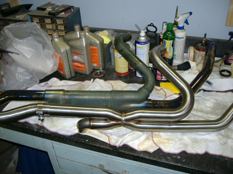

The factory head pipe is all welded, no clamps. The section of pipe your referring to is one piece and welded into the fat section where the catalytic converter is located. In the picture below is the stock head pipe and a Fuelmoto Jackpot head pipe, the Fuelmoto pipe has the extension clamped on.

I have to apologize msocko3 you was correct it is welded on the one side,I crawled under it and the clamp I seen earlier was for the heat shield,the pipe for the left side is welded.I dont understand why they would clamp one side and weld the other.It looks just like the picture you posted.So much for saving a few bucks.I will send a message back to V/H to let them know that the new Tri Glide still need the mid pipes.Any head pipe will fit onto there mid pipe correct?Im fixing to place a order and want to make sure I get everything I need.Im going with the Cobra Powerport Dual Head pipe,{I like that it looks like true duals}and V/H Slash Cut Slip on Mufflers.So will the V/H mid pipe fit the Cobra Head pipe?

Not every head pipe will fit the extension, the head pipe has to be the same diameter as the extension. I don't know if those pipes will work or not. If they do work you will need 2 of the extensions because the cross over pipe on a 2 wheel bagger and a Triglide are 2 different lengths. You may have to talk with Cobra to see they will fit.
