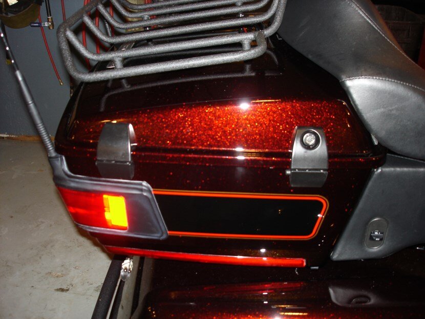

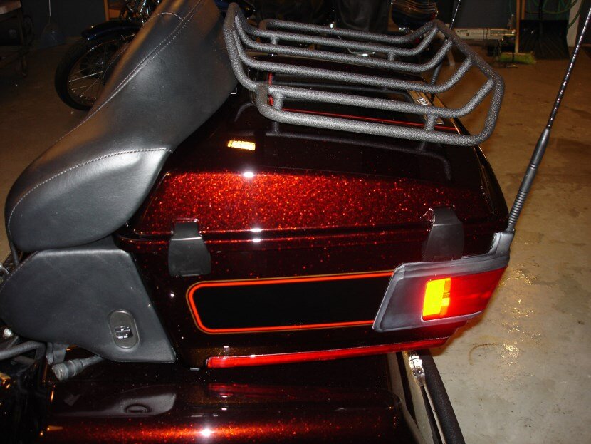

I installed the hinges on my TG when first purchased it and I am very happy with them. I was afraid the original cheap hinges would break and damage my tour pack.
I installed a set of them myself. They are much stronger, thicker, and more solid than the original hinges. They do not rattle either. If you go to a dealer, pull 'em outta the box and compare, you will see the big functional differences. And they do look way better to top it off. You have to take the lid off and drill out the rivets holding in the old ones, then drill the holes just a size bigger to fit the new ones. I am not very mechanical but was able to do this with no problem. Very happy with them....you will be also.
I put both hinges and latches on. I like them both.
