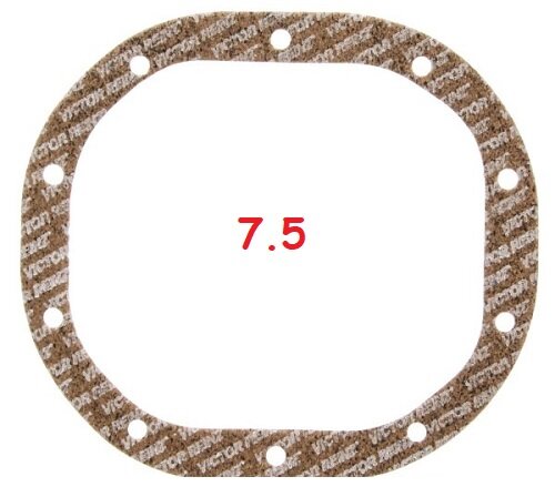

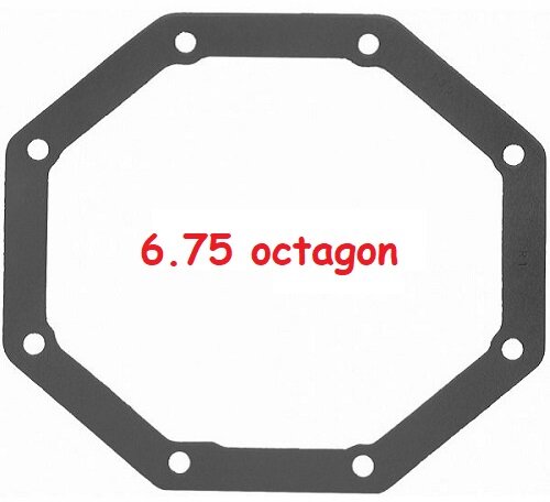

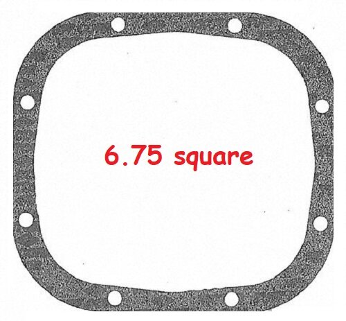

If I remember correctly, it's either a 6.5 or a 7.5. I do know it's a 4.10. I tried lowering it to a 3.73 to try to get better mpg, but the trike was gutless and would barely go up a hill. The little 4 banger needs to get the rpm's up. I do know when we pulled it apart, it wasn't set-up correctly and the gears were rubbing on the case. I had it set up on a dyno and got some more horsepower and torque out of it. Fuel mileage went up slightly also. Rick
