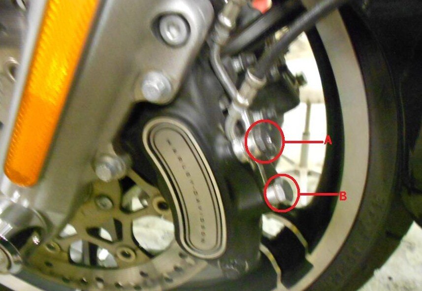

Left front caliper upper port (A) both lines are tied together w/double-banjo bolt. Lower port (B) is plugged. The bleeder needs to be opened with the OEM dust cap installed so heat will not expand the brake and lock it up.

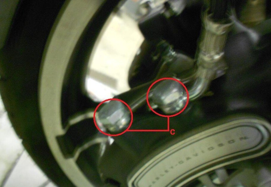

Right front caliper (C) both lines are plugged and both bleeders are opened with the OEM dust caps installed so brake won't lock on it's own.

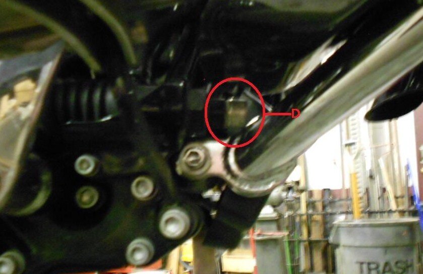

Front bottom view of the rear foot brake master cylinder. This is plugged with a 14mm bolt (D) so that fluid will not back feed into the master cylinder. I used copper banjo washers on all connections. Retain old hardware so that it can be reversed.
