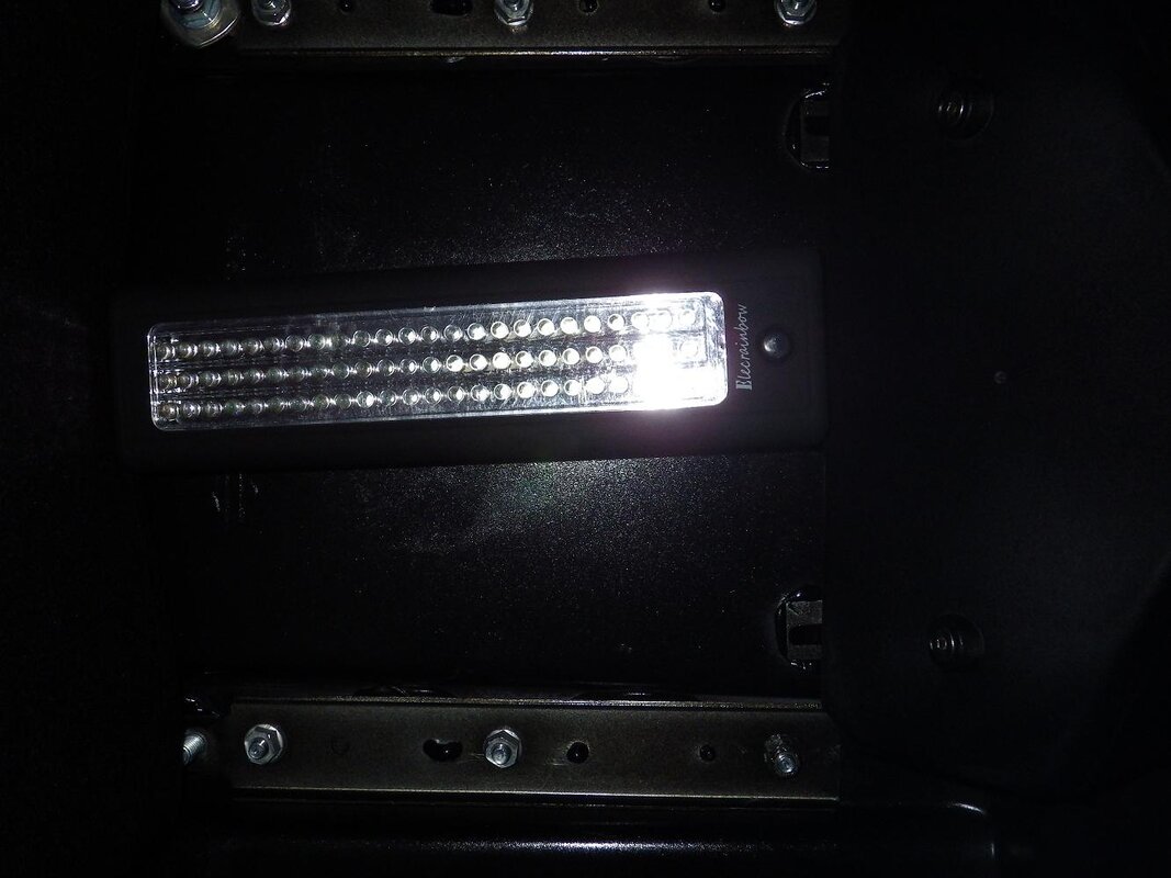

I got you PM, and went out to snap a pic. There are 3 (7/16") nuts on each side that hold the Tour Pac on.

There is a better pic of the underside of the trunk top in the last post of this thread.

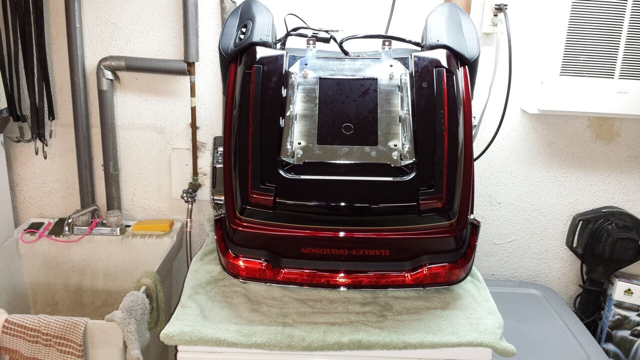

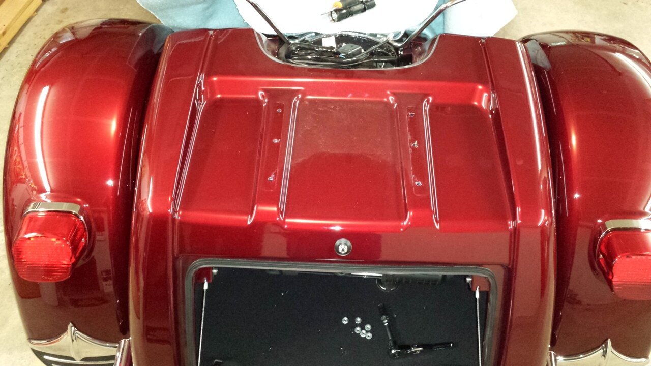

I removed my tour pack and I got lucky and found a rack. My tour pack has 4 bolts that screw into welded on nuts on a flat metal bar inside the top of the trunk. My trike is a 2013 Tri Glide. My question is what is the braided ground wire for that's attached to one of the bolts inside the trunk used for? Also if I cut the nipples off of the plastic tits that hold the flat bar to the inside of the top of the trunk will it come off easily?
Braded ground for antennas
