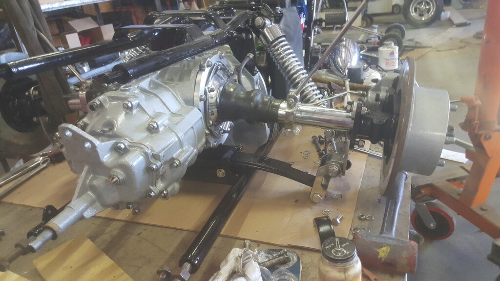

I do not have that model.
But my fenders are mounted to the axles and move with the wheel.
I was difficult to get them stable as they take a hard shaking and break the mounting.
I had to triangle mine to the axle to steady shake.
A rod from top of fender to axle for in and outward.
Then an attachment at the front edge of fender to the swing arm for fore and aft shake.
That looks very nice, think I need to add some braces to address the shake, not easy on mine as there are limits to where I can attach them. Btw, would love to see the trike when it's all together.
