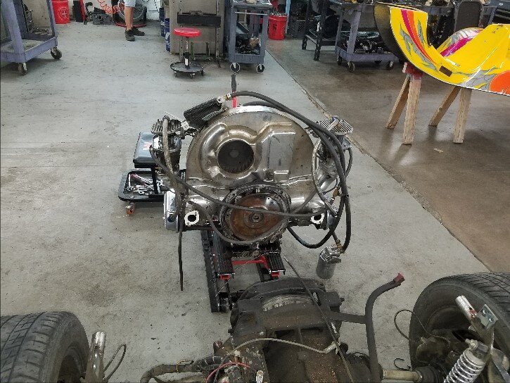

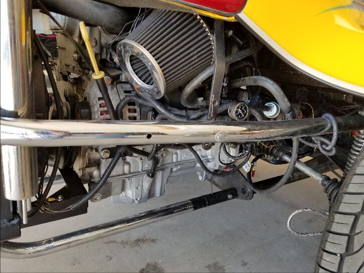

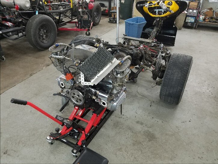

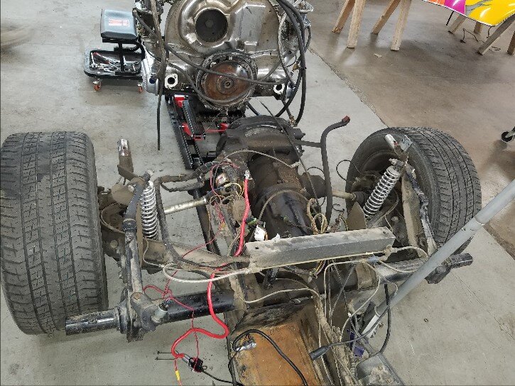

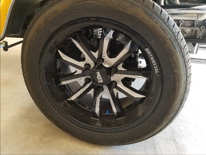

picture of engine swap

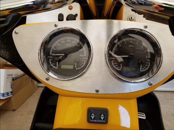

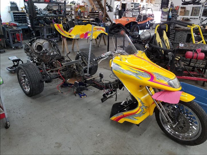

a few pictures. still in the works is the tube front end with larger tire and dual disks, ultra slim razor tour pack with 8" JL marine speakers/w JL Audio head unit. Gives me time to think about paint or wrap color.:)
