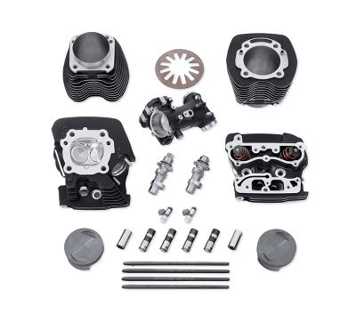

Just completed stage 5 on my 2015 Freewheeler. Went from 76 horsepower to 118 horsepower with 130 lbs of torque. A real nasty machine now. Pull the front wheels off the ground, guess I will have to mount some wheel extensions on back to keep it from going backwards and over. Put Vance/Hines headers with M/F extensions. Its got a real bad case of heart burn the way it sounds.

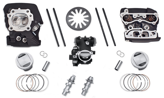

4.0" cylinders, SE CNC-Ported Cylinder Heads, matching 10.2:1 forged high compression pistons and rings, SE-259 cams, perfect-fit pushrods, high-capacity roller tappets, cam cover gaskets, heavy duty clutch spring, high flow fuel injectors
Screamin' Eagle® Super Tuner
58mm air cleaner and Cam Drive Retention
Just a few items to name.

I digress found what they are selling as a stage 5 http://www.harley-davidson.com/store/screamin-eagle-110ci-stage-v-tire-shredder-kit

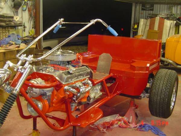

but if ya want grunt i h ave a 425hp trike, that Ive never rode. My pard has tho. Selling it, and i have a 99 twin cam e glide trike, a 69 shovel trike, all low on power compared to my v8 trike or urs.
I understand the desire, i truly do, seems Harley could offer a trike like that already with engine in place and jus pick Ur pocket some more and go on.
