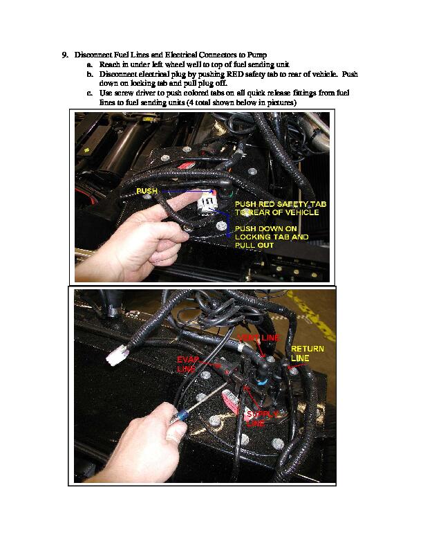

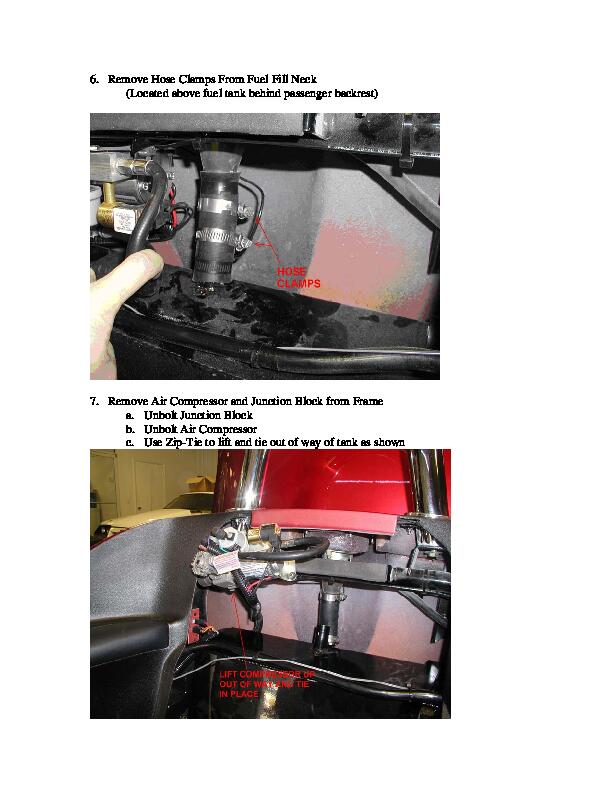

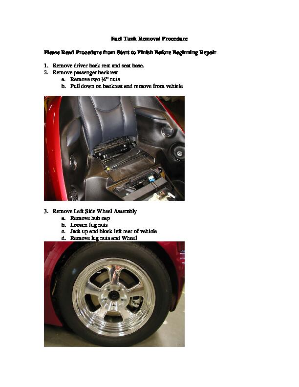

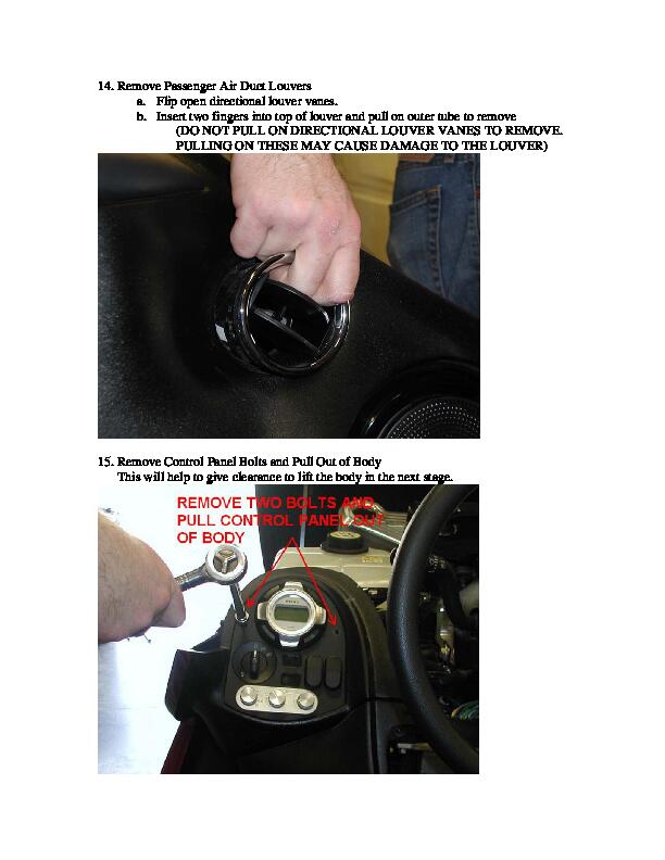

I'm posting in case anyone is wondering about the answer to removing the fuel pump. You can expose the fuel pump by removing the rear seat back rest. You can test the electrical of the pump. However it is not removable at least on the 2009 model because the fiber glass body covers part of the pump. The only way I am aware of to remove the fuel pump is to remove the body.
