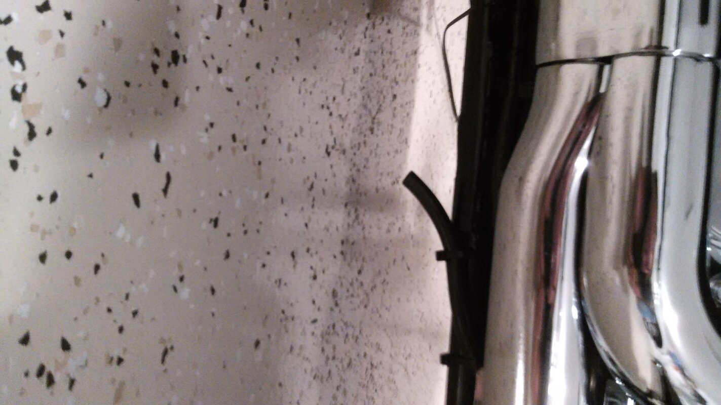

I installed the Stock Air Box back on our 2017 trike today. I also re-installed the (EBS) catch can set up I had previously used. I decided to re-rout it out of the air box and re-rout it under the frame.
I think it turned out well. I had to make a clamp and mount it to the existing exhaust clamp (see pic hose running through clamp).
I had to drill a small hole in the stock air boxs bottom for the hose to exit and rout the path of the hose not to touch anything and not to get melted.
Ride Safe All, :)

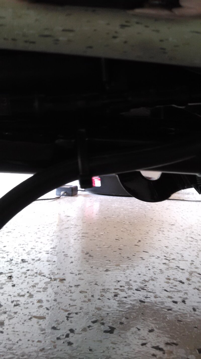

OK I did your mod,
All 1/4" with barbs on the fittings . Will not come loose. I show a pic of the holes I drilled in the air box the smaller is for a drain may not be needed but hay I was in there
, 1/2"hole for the 1/4" ID fuel line. Plugged the back of the paper filter were the stock line went in. All went well and $28 at Ace they had it all.3 ft of 1/4" fuel line 2 mini clamps 2 90* nipples 1 Tee all with barbs. Thanks Bill G.
These new breathers do not breath as much as the twin cam going by what I felt before the hose install at the breather bolts now it is all out the hose to atmosphere.
