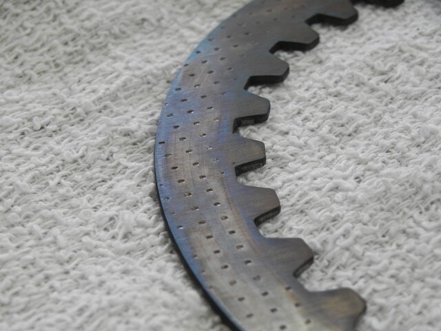

I don't like the truth either, but I'm guilty for not putting 2 and 2 together earlier. However, synthetic oils are known for less gripping when clutching. This customer always uses synthetic oil. I've seen others, and thinking back, they used synthetic oil too. This one is a 2 whl GL1800 with 53k. A clutch that grips less means more time in the friction zone. More friction causes more heat, which causes uneven surface, causing more heat, and enough heat causes clutch plates to warp. The blueing represents heat. His clutch plates are not yet warped.
Below is a pictures one of his clutch plates. He reports using Amsoil.
Here are some things a rider can do to lesson his chance of clutch failure.
- no slow racing
- fast clutch action
- at a stop on a hill, do not feather the clutch to keep position. Use the brake.
- no drill team maneuvers
- do not trailer
- do not use synthetic oils
I have used AMSOIL motorcycle oil in the three GL1800s I have owned first one had nearly 60,000 on it when I traded it. Second one had 120,000 and I'm coming up on 25,000 on number three. I pull a fairly heavy trailer quite often and have been know to be less than kind to the transmission. There must be some other reason for the failures you are seeing. I just do not see the AMSOIL (no affiliation) having any negative effect.
That looks like a classic case of owner accelerating before they have released the clutch lever. :gah::xszpv: :xszpv:
It was actually my transmission guy who reminded me of the known issue when using synthetic oil.
I'm sure there are more, but as stated above, any these can contribute to burnt clutch plates. Also, "can" is not the same as "will". As with your experience, I know many with much higher mileage and using their Wing like you and using synthetic oil too, who have never had a clutch go bad. For me, I had a clutch fail at 22k trying to win a slow race. At the time I was using Honda's semi-blend synthetic.
- no slow racing
- to much time in the friction zone
- do not trailer
Yes, I agree Greg... Probably way more synthetic users never suffer the ills you speak of. That is why I mentioned there must be other contributing factors. You mentioned several things I have to admit I do not do so they are probably very valid and I to would recommend steering clear of.
It's sort on coincidental that you mention the AMSOIL as a possible contributor when the synthetic oil lubricating ability and my riding style is exactly why I chose to start using AMSOIL... Go figure... :) :xszpv:
I mentioned Amsoil, in hopes that some won't think that it's caused by a "cheaper" synthetic. It's also relative to the situation in the sense that it's what he says he uses.
