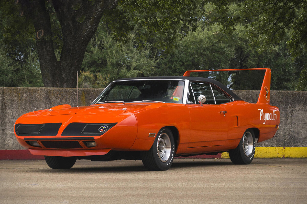

Technical info.....
Fins and spoilers on street cars do not do much other than look good. Some carefully designed ones are more for reducing turbulence and therefore making the car a bit more slippery......increase gas mileage. I doubt any under 100mph fins are intended to create downforce.
The only truly functional down force fin/spoiler I can remember seeing on an amercan street car is the super bird.

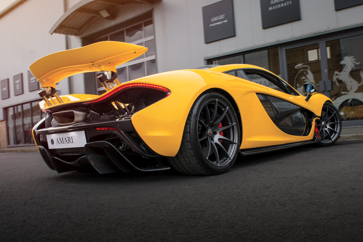

The euro super sports cars do have functional down force but are designed to run 200mph. They typically are powered and lift up when at speed.
