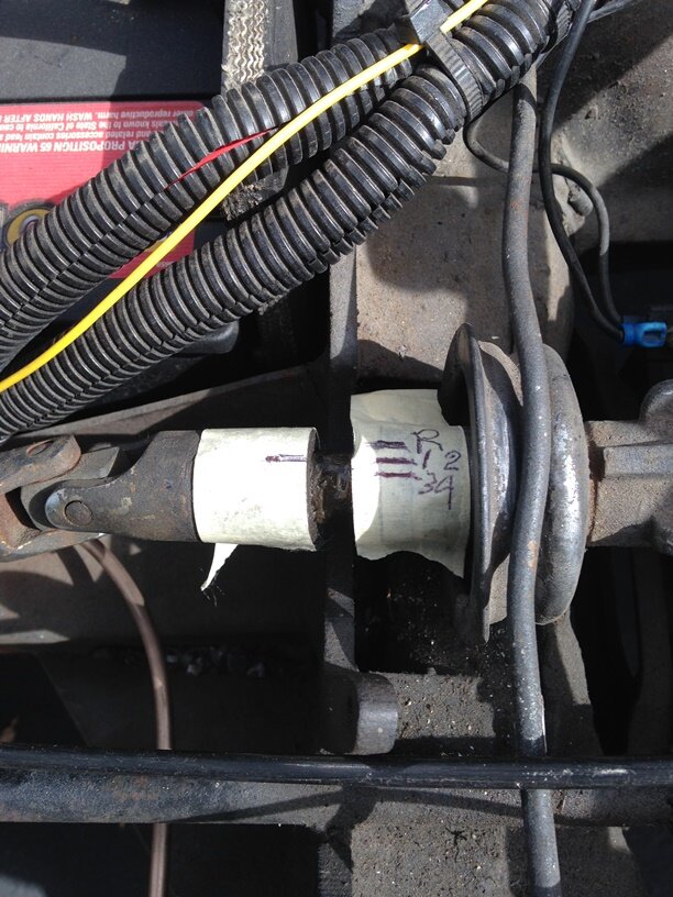

In other news...my new shifter arrived. Empi short throw for right side drive cars. Difficult to adjust properly with the body on, and I'm a little disappointed in the lack of precision on the fit of the ball into the linkage socket in the shift box. Good news is I know how it works now so I may be trying to duplicate the mechanism in a shape that doesn't get so close to the passenger peg.
All this trouble after someone got me all excited about a Black Mamba shifter, but they are way too spendy for me!

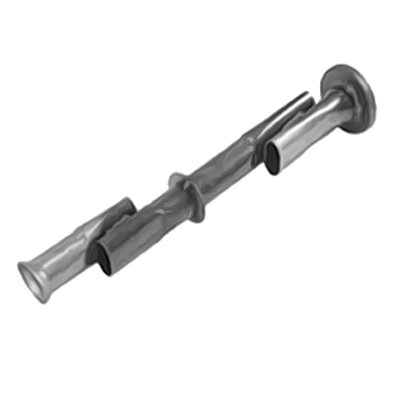

Carb icing?
I had a busy couple weeks while I tried to figure out a stalling issue. Noticed when coasting to a traffic light with the clutch disengaged, it would quit but restart easily. If I gave it just enough throttle to stay running while coasting, sometimes it would stay at idle while waiting for the light to change. After a lot of research on the samba, cleaning the carb ( it was clean and looks new in and out) , setting the valves, plugs look good, compression is good on all four, checking timing, I finally stumbled on posts about carb icing! So I used my infrared thermometer to measure temps on the engine after a hot romp and a quick stop. Found block temps up to 175 *F, and carb temps at mid 60's F! Finally cured the problem by cleaning a little carbon out of the manifold preheat tube that runs from one exhaust pipe to the other, boy was I surprised that worked. So after a bunch more reading about the "infamous" flat spot on a 34PICT3 carb, I experimented with accelerator pump output and cured the stumble with almost max stroke on accelerator pump. I am so pleased with the way it runs now and how nice the idle is. I didn't even use many choice words! Nice how the info is out there if you read enough stuff....
:confused: Very intersting info, why, because I have that cross over tube on my 1600. I will have to put this down in my book of tricks and what can happen. Thank you for sharing this information and have a great week.
