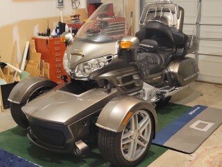

I purchased a 2004 honda gl1800 with the Motor Trike Prowler RT reverse trike kit. It is great and very stable. It was installed by Leola Motor Trike in Pa. They do excellent work and are easy to talk to with any problems you might have. Great people.

IMO- Get a Roadsmith or CSC trike. They are the biggest companies and been around a long time- 40 years for Roadsmith. Test ride each one and see what you like
I have a 2010 wing, and went with a Roadsmith kit............. Very happy I did ..............
JUST DO YOURSELF A GIANT FAVOR............. and get the 5.5% rake kit ... This will MAKE OR BREAK your ending decision, on whether or not you made the right decision..... (It makes your steering feel like power steering/instead of a hard steering
