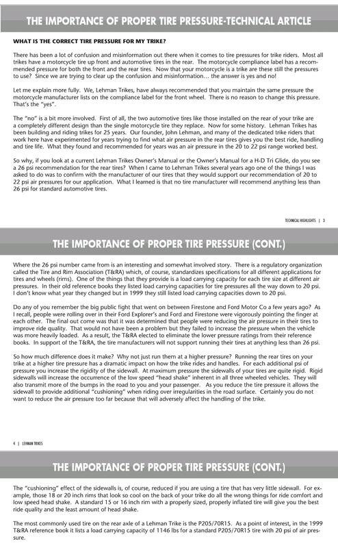

Take a look at this screenshoy if a manual. I know it's for a different brand (Lehman Master Manual) but it has a very good explanation on the rear trike tires. Hopefully you can enlarge it and be able to read it.

So I set both tires to 20 psi and the ride is better as well as the handling, may mess with it further as time goes by.... left front tire at 42 .... Its a VTX1800T with a Motor Trike Conversion.... Has 5 way adjustable shocks and air bags as well .... Looking forward to taking it on a color tour in northern Michigan this year...
