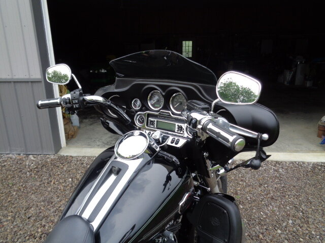

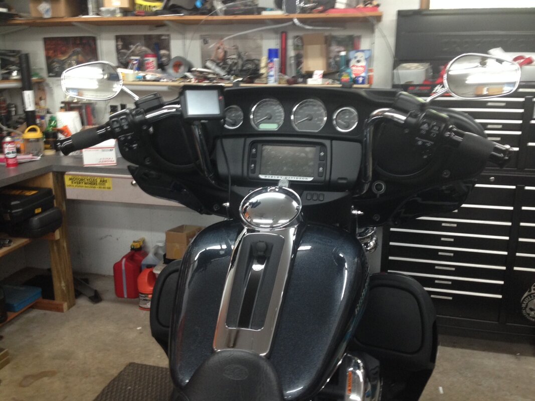

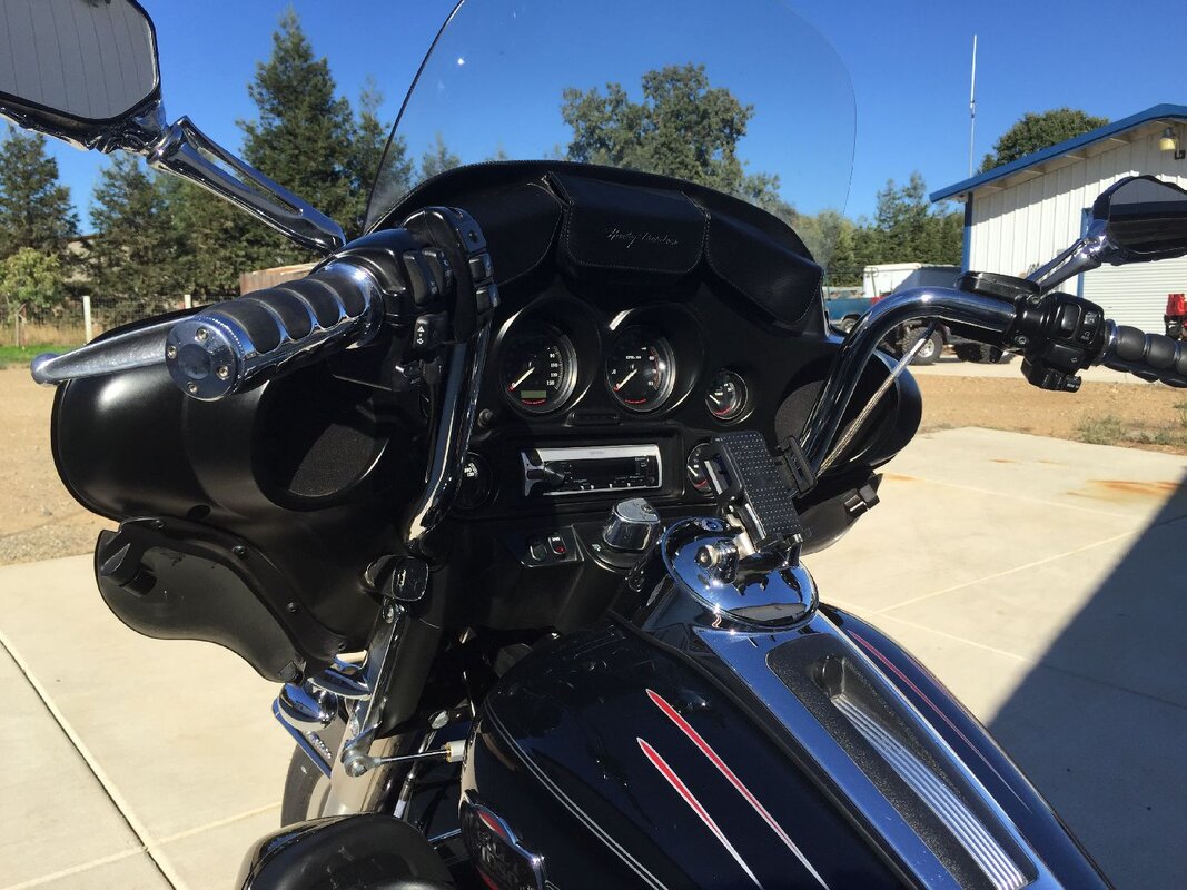

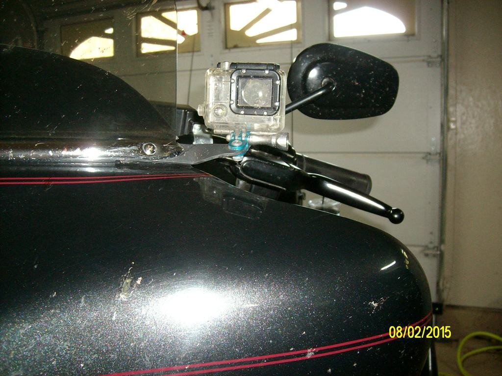

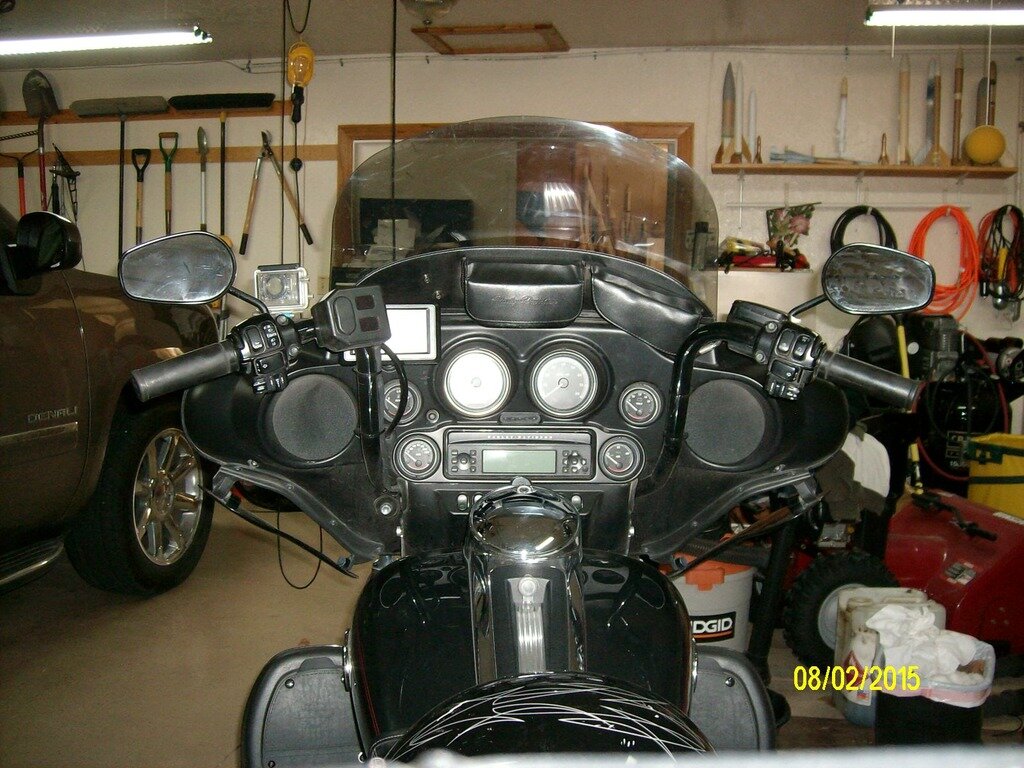

DSC00110.JPGDSC00111.JPGsignature pic..jpgI changed my bars for Khrome werks MFG. #300517A 34.3 inches wide 2" higher 2" pull back oem 30.75 wide.

View attachment 29101View attachment 29102View attachment 29103I changed my bars for Khrome werks MFG. #300517A 34.3 inches wide 2" higher 2" pull back oem 30.75 wide.

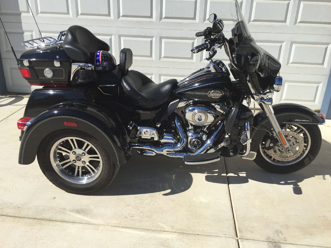

I put the Harley 12"batwing apes on My '15 TriGlide.Much more comfortable and a little easier steering.Specs are on Harleys website .Basically 12" rise,35" wide, 1-3/4" pullback
The dealer did it as part of the deal.They were already going to have the fairing off to do the chrome forks and the sirius Radio module, (which I paid for).I don't know how long that part took.

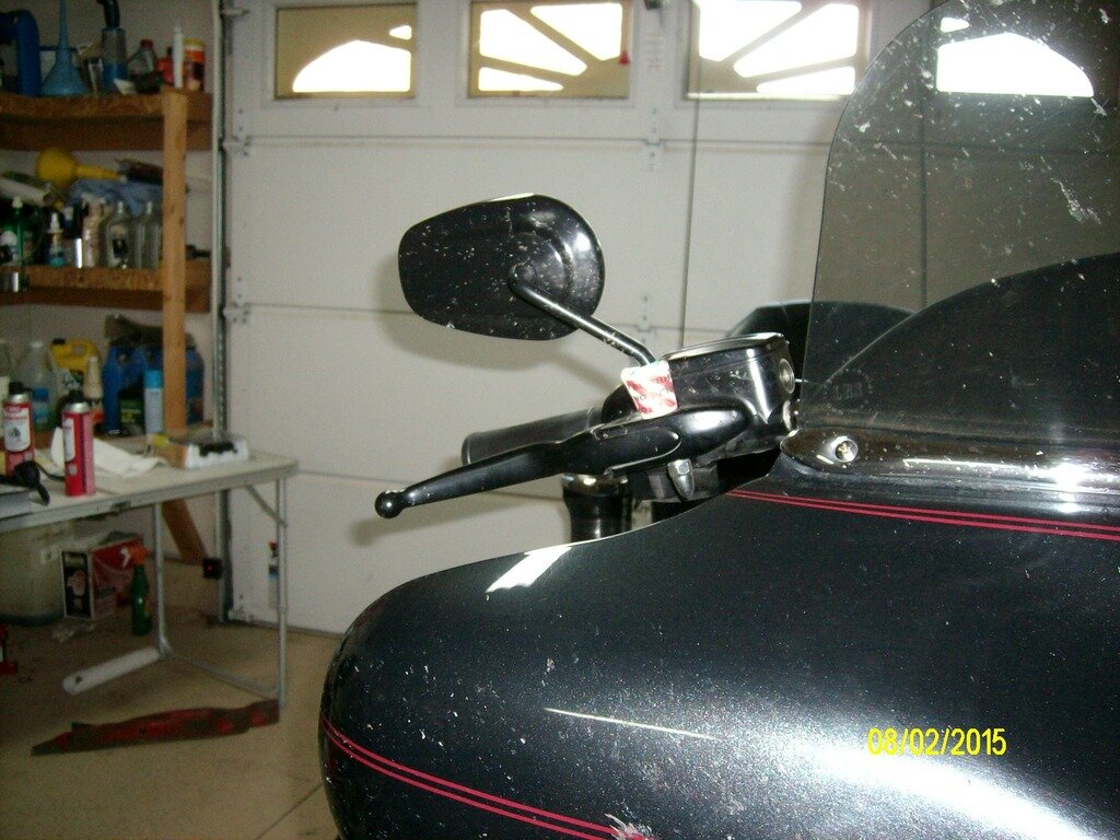

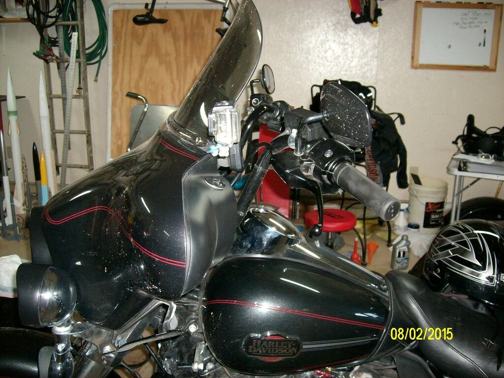

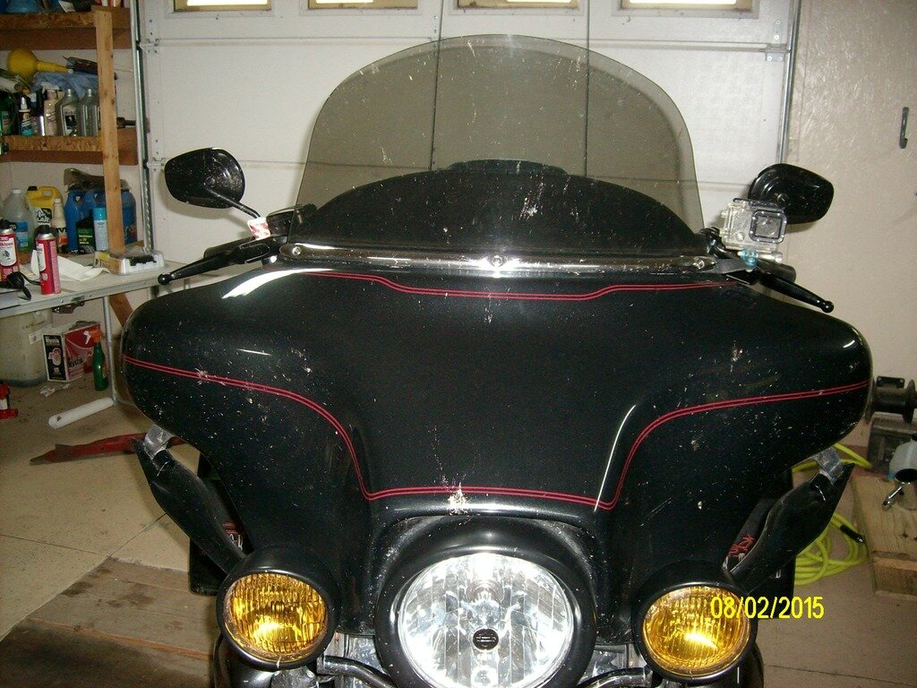

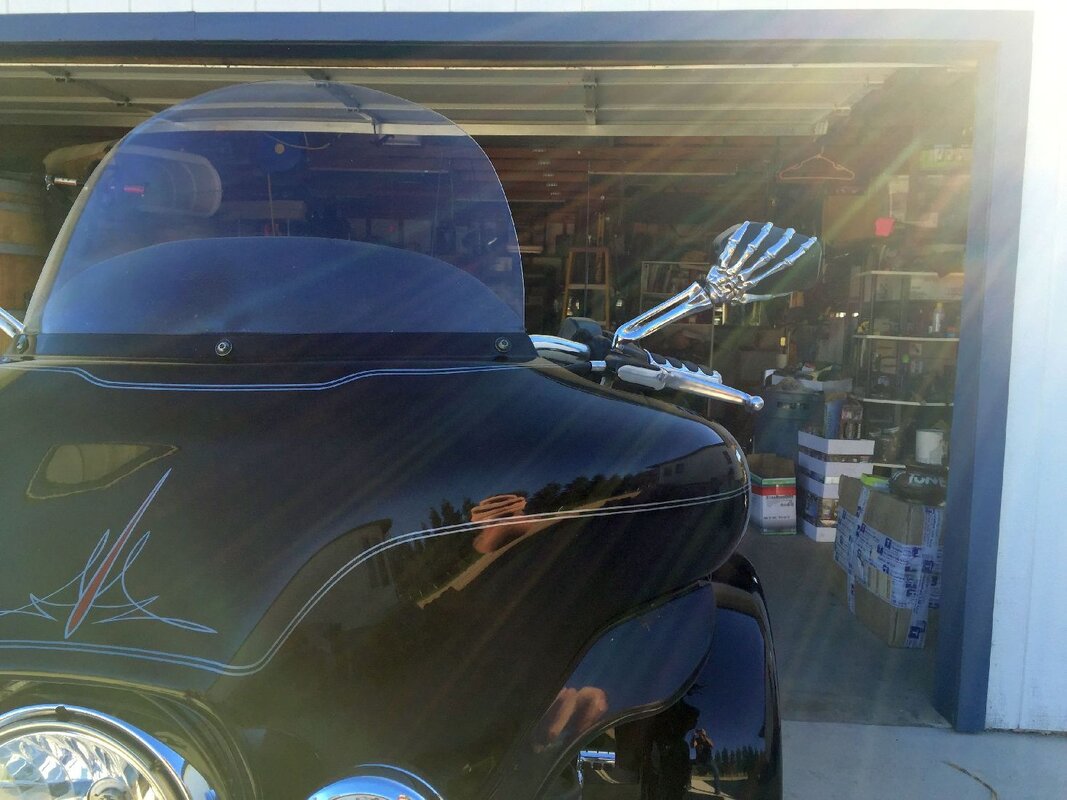

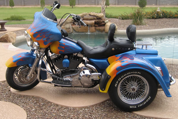

These are Paul Yaffe 12" Classic Bagger Bars. I had stock bars on my 2009 Electra Glide, then had a Motor Trike installed. With the rake kit I was leaning down to reach the handle bars, the rake kit it seemed, lowered the handle bars. My back was killing me, got on the internet and started researching bagger bars.
The bagger bars come just to the top of the faring, my hands catch more bugs now but my back doesn't hurt. With my hands on the bars my hands are about chest high, very comfortable.
I hope these photos help in your decision.
