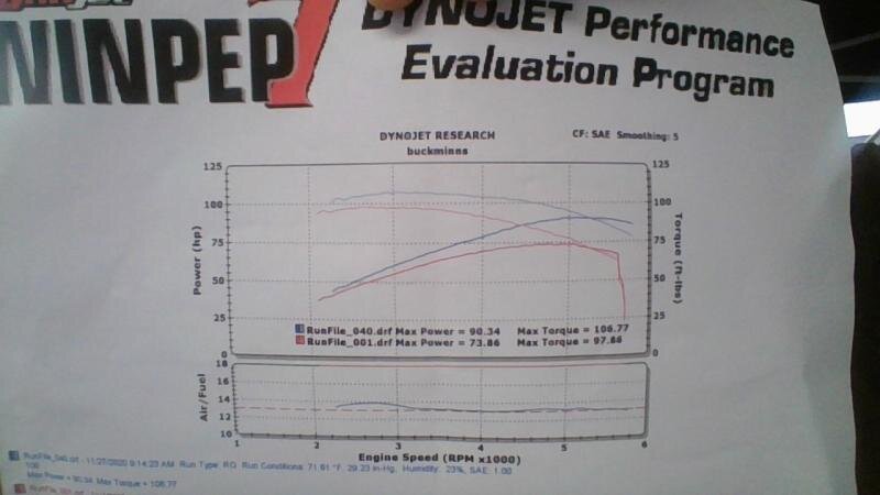

On my 2017 I went with the S&S 465 cam and really glad I did. As you can see it is making over 100 ft lbs of torque at about 2000 rpm.
