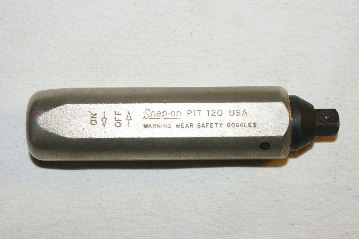

I bought this impact driver in 1966 to get the engine covers off my Yamaha which were phillips (worse that torx!)
I use it all the time. :D
Bob :Dorag:
