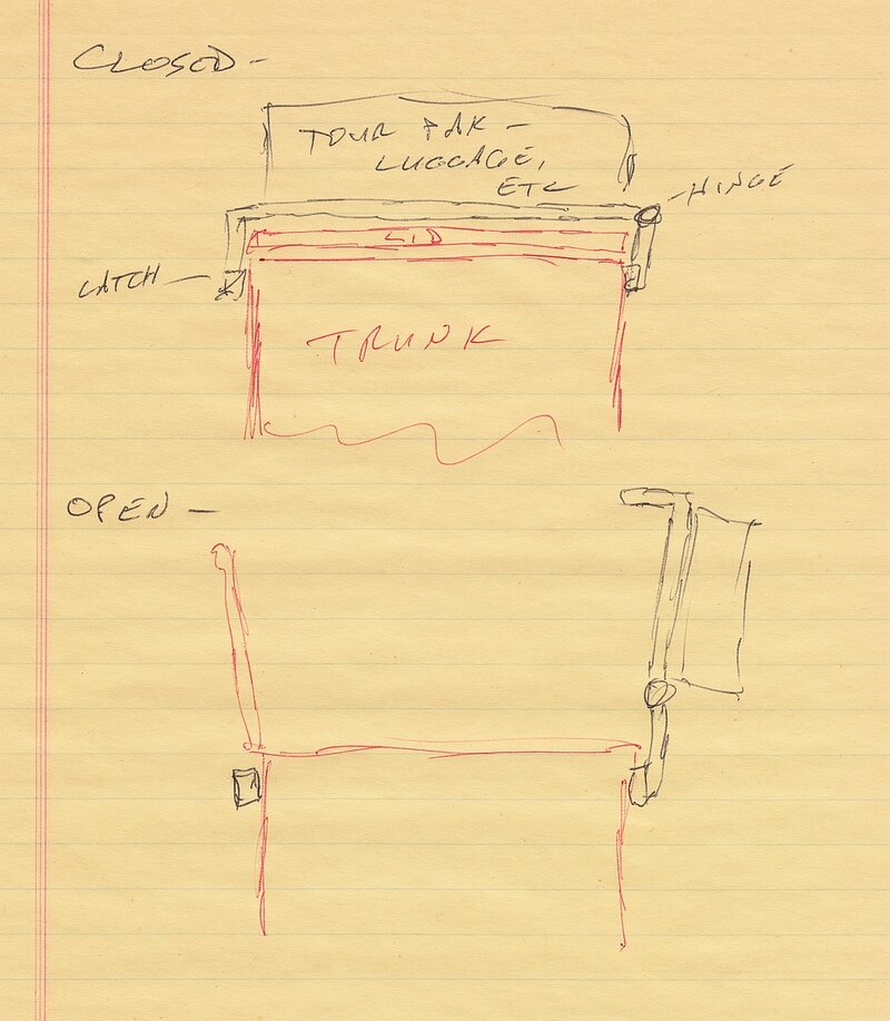

When I bought my Free I looked at the idea of adding more storage. Didn't want to add to the trunk lid, but thought about going over the top of it. Put a hinge on the right side of the trunk, a latch on the left, and the tour pak could swing up to the right and the FW lid would be clear to swing to the left. Penciled in a basic sketch, then decided I didn't need the extra space that bad. Here's the drawing if someone's feeling adventurous...

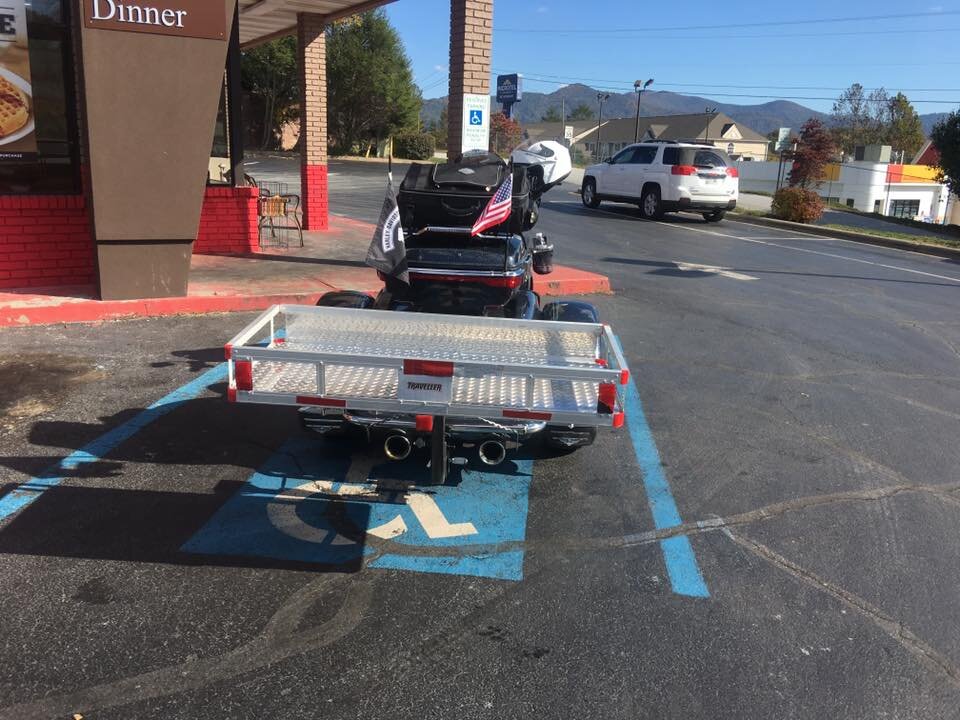

Rack is approx 48 x 20. YES Common sense prevails as to not loading a lot of heavy stuff on the rack. He travels with the trike trailered behind a RV. The rack is used to go shopping with the trike when the RV is parked.
tour pac
I wonder what Harley would say about a rack like that. Do you think they would void the warranty because of there being a trailer hitch on the bike or if you had pictures of the rack would they be ok with it. in my mind they should be ok but who knows. A rack like that would be very helpful for carrying camping gear. I myself would make it a little smaller but that's just me.
