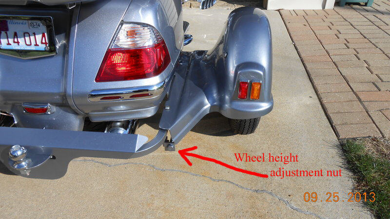

My brother in law has one on a 2005 Goldwing and the tires lay out at the bottom how can that be adjusted to ride straight . He gets very little mileage out of tires , they wear on the inside bad because of wheels laying out .:gah:
Almost sounds like he has too much down force on the wheels... Tow Pac told me that the proper force on the outrigger wheels is such that you can just turn the tire when grabbing it with both hands and try to turn it... In other words, it should be fairly hard to turn, but you should be able to turn it with some degree of effort...

That's what I have come to think but looked and can't seem to find any adjustments to raise . I did raise it as high as it would go in the back and helped a little but I'll check again ,,,thanks a lot I think that's the problem now just to fix it .
Let me ask you another question ,he's running the air suspension about half way , by airing it up should put less pressure on the tow pac I would think . How tight are you running yours .
My bike a 2009 and I run the rear suspension at 5 ... IIRC, increasing preload (higher number) removes weight off Tow Pack and decreasing number loads the Tow Pac with more weight... You should also have wheel height adjustment on each wheel - the large hex head adjustment in the back... See the photo below...
Les
ThumbUp,,,,Thanks Les ,,,I had him bring it to the shop and found the adjustments I was looking for you've been a lot of help . The wheels are almost perfectly straight now again thanks even though it's not mine I hate trying to fix something and can't seem to get it .
