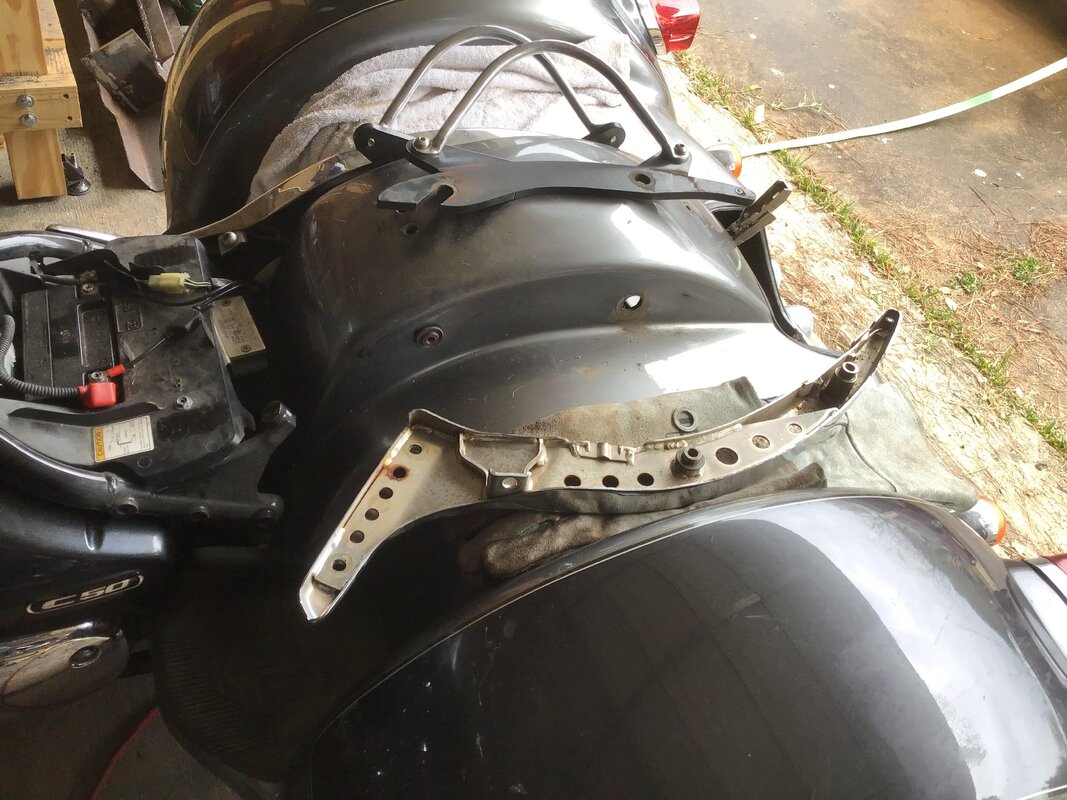

Images of what’s under there.

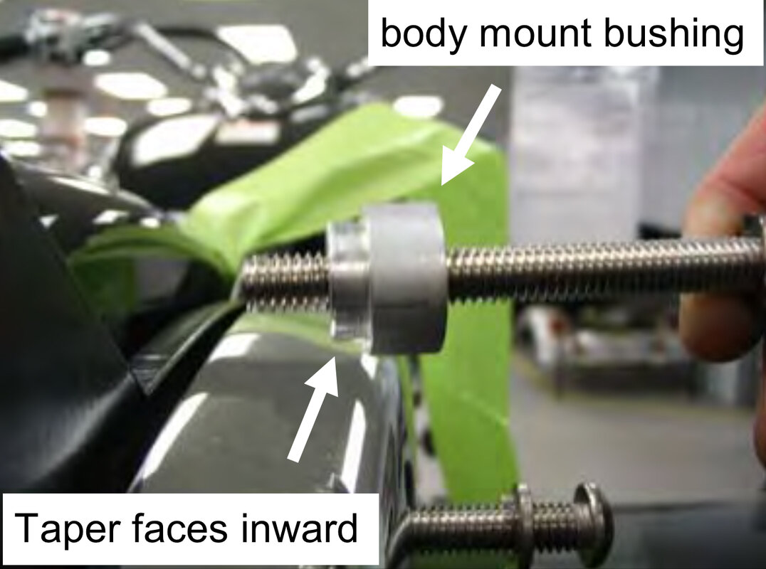

With this specific machine, some corrections to the manual. This body mounting bushing-
-does not exist. Here’s a pic with the (black) grab handle brackets and the (chrome) frame handle grips removed.
Notice the integral bushings factory welded on the Suzuki frame handle grips. Where the fairing is pierced, the forward mount- through which passes a spreader tube -features a rubber bushing; the rear hole is oversized, matching nothing, the rear bolt received on the inside of the fairing by a large, slightly concave fender washer, capped by a lock nut. It seems to me the design likely once included a second spreader tube; whatever the case, the Tramp rear fairing is not directly supported by the back bolts passing through the frame handle grips. I reckon it best to avoid loading the fairing significantly behind the spreader tube- the exhaust already depends directly from the rear fairing. I had planned to locate an auxiliary fuel tank in the trunk, but now question the viability of locating 24 lbs of fuel there.
Contrary to the narrative in the manual, the grab handle brackets are trapped by the frame handle grips, are not independently removable simply by clearing the rear bolts. Without the grab handles, some sort of spacer would needs be contrived to secure the fairing to the frame handle grips; it’s also unclear if the brackets are necessary for augmenting strength of the frame.
Take note that the fairing should be supported by blocking before removing these bolts, else all the weight of fairing and exhaust will be born by the passenger step connections.
