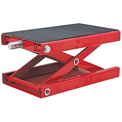

Question: Where is the lift points under the engine to do this safely?
I use a flat paddle-jack just beneath the front of the engine, behind the oil filter.
