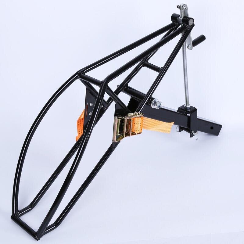

RSW:
No, the solid type carriers as shown in the eBay advertisement work beautifully for two-wheelers, but the geometries of our trikes require a carrier that is hinged horizontally to keep stress from being generated in the front wheel/steering neck areas when turning corners. Since this is not a new subject to this trike forum, perhaps someone can refer us to a better explanation, or maybe even a diagram or two to better explain the problems encountered.
RSW:
Sometimes my thinking is a little slow, but understand what you are talking about. The stress on the neck would probably worsen the higher you lifted the front end. If you kept your receiver height low, wouldn’t that make the stress level lower? I think you would have more neck stress if the trikes rear wheels were unleveled. Maybe a deep pothole or running off the edge of the road. I think more of a swivel action would be needed then horizontal hinging. Or is the same thing. My need for one would just be to tow one home if I have a breakdown. This just hit me when I had to limp mine home with a ignition problem the other night.
Try this - set the front forks of your trike perfectly straight (front wheel will be perfectly vertical). Now turn the forks full-lock to the left and you''ll see that the front wheel leans quite a bit into the turning direction. The solid tow bars make a trike turn like that but try to hold the wheel perfectly vertical, therein making significant strain on the neck. Yes there are some of them out there on the road, but it's just a matter of time until they have some major problems such as broken or bent-spoke wheels, cracked frame necks, etc.
This is not a new subject in the trike forum(s) and is something that should be avoided when selecting a tow bar. Look for one that has a horizontal hinge, or uses a regular ball receiver. Plus it would ideally attach to the trike frame at the back end to take all strain off the neck area.
