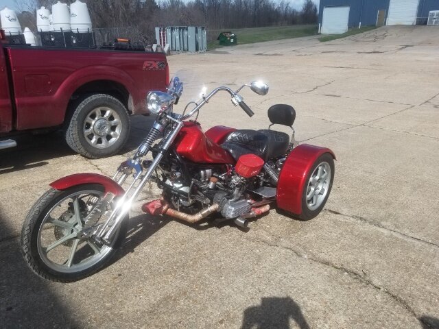

Jaime........Welcome to Trike-Talk.... , Thats a nice looking Trike.....

I have built one.
Look at the stickies at the top of page.
My thread "Anyone Else" has my latest build.
As far as the crown gear....you must have a two side cover trans. You can then pull the crown and drive out one side and put it into the other side. This reverses the drive direction.
I did mine by flipping the entire trans. I would not recommend that for anyone unfamiliar with the internal workings of a vw trans. The trans must be fully disassembled and internal machine work done. Then fully assembled.
I have prints on the drive adapter and the input shaft for the extension housing if you pursue.
And......
That is me in the top pics....just a long time ago.
It looks like this now.
The valkyrie still looks the same.
Stock off the shelf Honda. You can buy them all day on ebay.
