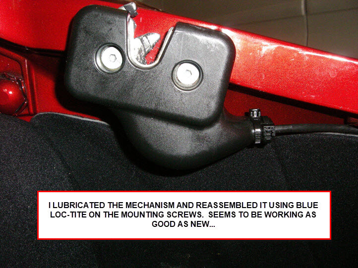

Okay, so, HD dealer drilled a tiny hole in the trunk bottom, a tinier hole in the trunk liner, and fished around with a long screwdriver type thing until they made contact with the latch.
Said it took 2 hours, but all warranty work.

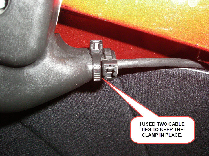

As mentioned in HDBOB posts, 1 of the 2 screws fell out, and the latch was crooked. The HD recommended fix? Lockite on the screws, and as a precaution, a small zip tie holding the cable to the cable bracket.
