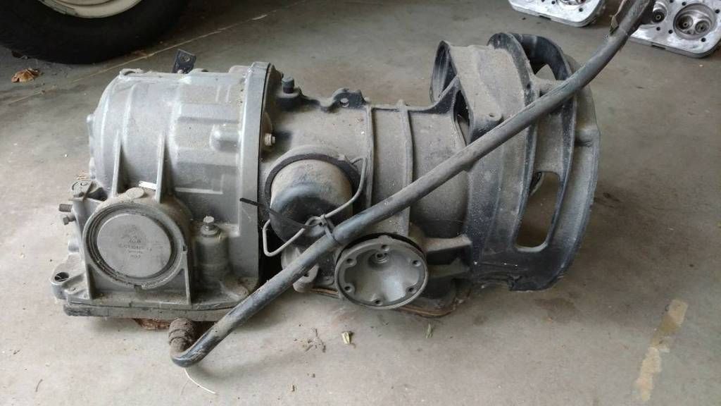

Hi I found a rebuilt type 2/4 automatic transmission really cheap at a time when I am ready for one in my build.
My frame is set up for a type 1 and I wanted to find out if someone has done this conversion and whats involved. All I can find are numerous mentions of type 3 autos but no type 2.
All my research could find is articles putting a type 2 MANUAL in a type 1.
I don't know how to support it or how to shift it and I do not know what to do about the cv joints and axles. I cant even find a diagram of the Type 2 original shift linkage.
Not like the old days when you could just go to the junkyard and look at how its set up and supported.
This is where it is going.
As always, any help would be greatly appreciated.

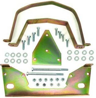

While I have not specifically done the adaptation you describe, I have done some work with T3 auto into std IRS suspension. And so far as I am concerned, most anything is possible if you follow some basics. So, here goes.
1) First, the basic measurement which is a must is the alignment of the drive axles (tranny and the wheels). Establish those measurements to set the positioning of the T4 tranny.
2) I find it easiest to use a strap-down aftermarket tranny mount kit (see photo below) - and they are actually available for adapting a T4 tranny (straight shift) to a T1 framehorn - look closely at photos of the T1 type strap-down kits vs. the T4 to T1 kits to select what you think will be best for you. The T1 kit actually cradles the automatic bellhousing a bit better for my use with T3 autos, but you decide for your project.
3) Install rear mount on framehorns and set tranny in its ideal position to align axles. Notice that lower frame support can be reversed to better fit the longer T4 auto if needed.
4) You will likely need to modify the front tranny mount bracket to fit your needs, but hopefully it will be better than starting from scratch.
5) With these components and a bit of modifying, you should hopefully be able to get the auto basically secured in your frame.
6) You will need to adapt some axles with the T4 CVJs on the inside and the T1 CVJs on the outside. You may actually have to come up with a set of the T4 auto drive axles to do that adapting, but I suspect no major type adapting should be necessary (but I can't guarantee since I haven't specifically done that). I know the T3 autos have 2 different length axles, so they are a necessity in that case.
Without getting too deep into the specifics, those are some basics as I would approach the situation. I find that aircooled.net and jbugs are both pretty good sources for tranny mounts and also have some adapter components. Both carry the strap-down kits I mentioned in 2) above (photo below).
Good luck. As always, my advice is guaranteed our your money back.
PS, I do hope you got the flex plate and torque converter with the tranny.

For what its worth (I haven't looked at this trans.), will the front body of the type 4 auto trans fit between the type 1 frame horns? Sure looks wider than the manual trans. If I remember correctly, the type 4s had the trans supported from the front mount, the top of the bellhousing, and the rear of the engine with no frame horns underneath. You may have to end up cutting up a nice looking frame to accomplish your goal. Measure, draw a picture, go away, think about it. Return. Repeat (several times). Then proceed. You should be OK. Good Luck and post pictures of your build.
