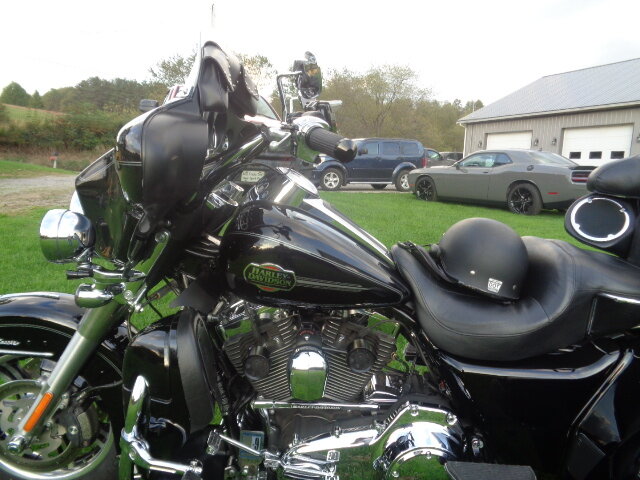

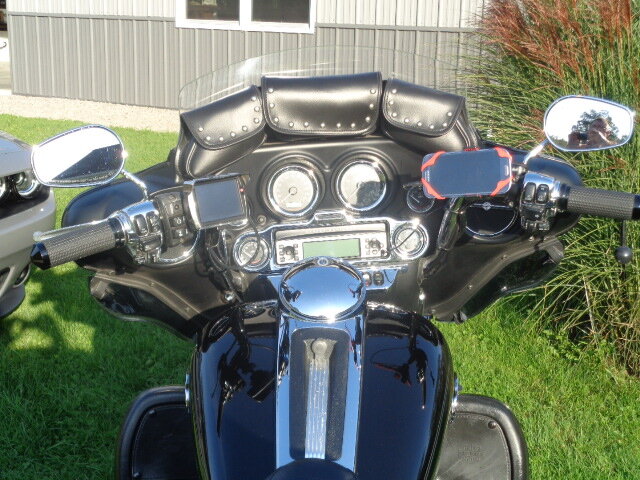

I'm 5'8" 30" inseam I have 2+2 wide sweepers Khrome werks bars check my photos in my profile albums good luck with the search Fred DSC01001.JPGDSC01011.JPGDSC01013.JPGDSC01022.JPGDSC01024.JPG

I want to add the wider bars make it so much easier to steer and the added height of 2" and added length of 2" of grips. However check out Khrome Werks website they have a full line on bars at a workingman's budget. I would have sold the trike if I had not found out about these bars have ended my back and shoulder issues on long rides for that matter any rides. Good luck in your search :good:Travel safe Fred
