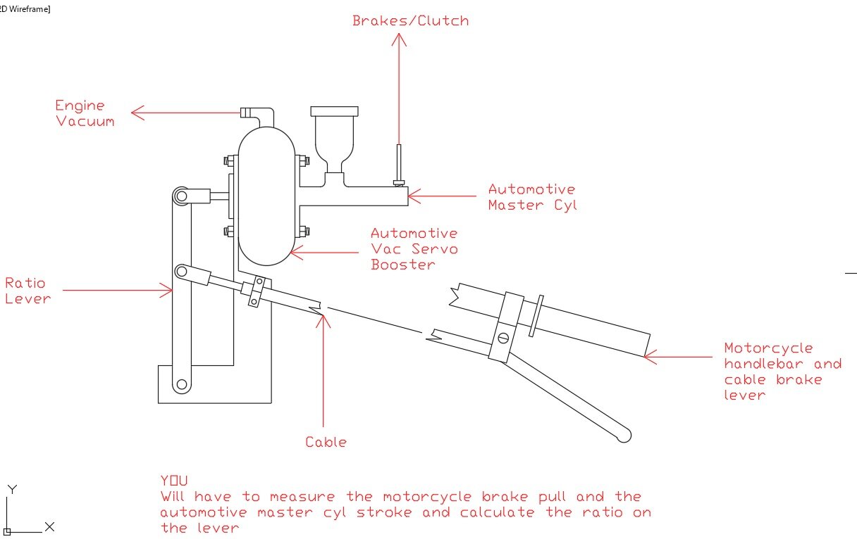

Now..... let me put down what I would do.
I would use the automotive master cyl and a brake vacuum booster. Then operate it by a cable and lever system.
But of course I am not afraid of making things from scratch and this would take a lot of custom one off work to pull off.
But If you have the resources look into it.
looks like it will work great.....vac res and mc can be located anywhere a cable can be ran, also easy to make a new ratio bar if a ratio change needed. wondering if this setup could be used for a power assisted clutch?? maybe a cam/ratio bar to spread out the clutch release and apply portion of the clutch travel? :xzqxz:
Clutch.....Yes
This idea was originally conceived with clutch in mind. Would work same clutch or brake.
Yes....if you wanted a variable ratio action you could make the double jointed knuckle set up like you see on a soft tail harley or a dirt bike swing arm (scaled down of course)
And....this was just a sketch of an idea. It is not to scale and no details are engineered out.
Venhill makes good cable kits.
McMaster for clevis and bushings.
Scap yard for a booster (servo) can.
A dune buggy single master cyl.
Then hand make all the other parts to make it fit together.
Like I said....I have not engineered it all the way out. Just tossing ideas. If anyone wants do it then go for it.

I doubt a monster cammed or turbo motor could work a vac servo.
But stock bugs did it on a clutch for the auto stick. The autostick had a vacuum operated clutch and a torque coverter.
So yes on the available vacuum on a stockish engine.
Then in the hot rod v8 world there are accessory pumps to power the booster with for cars with big cams and power brakes.
And even modern car....if the engine were to quit the power stearing and power brakes would quit also.
That Lexus part looks very interesting and is small. That is something to definitely research also.

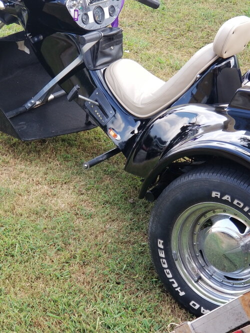

Hey guys sorry I been away so long on this topic. I had my accident in March of 2018 and it has been slow healing. I am still a t6 complete
so learning how to move around and do things from a wheelchair.
With that said on the hand brake this is where we are so far. Basically it is a handle replacing footpadle. So far works great. First stages of design anyways.
What do y'all think?
