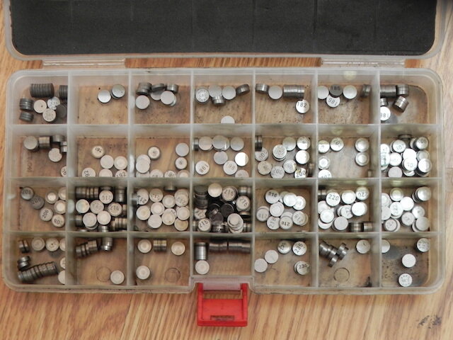

Unfortunately, many shops do not have an ample supply of shims in stock, and are not willing to tie up a bay for 3 days while they wait on a $7.25 shim. Often shops have production per bay goals of like a $1000 of labor per bay. Having a Wing tie up a bay for 3 days while waiting on a $7.25 shim does not financially work for its owners.
Another issue is shim inventory. As of Dec 31, 2016 the retail value of my shim inventory is $3059.50. If your shop sells chrome, many shop owners would rather invest their money in chrome instead of shims. After all, chrome is more shinny. In my case, I sell no accessories and provide only service. A completely different concept then most shops. I'm also the only GL1800 specialized service center in the world. A shop like mine is a real shop ... it survives solely on providing good, quality service and not making a Wing shinny.

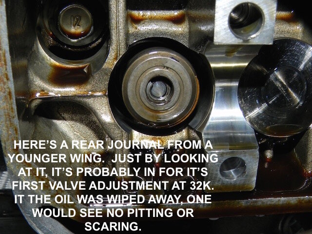

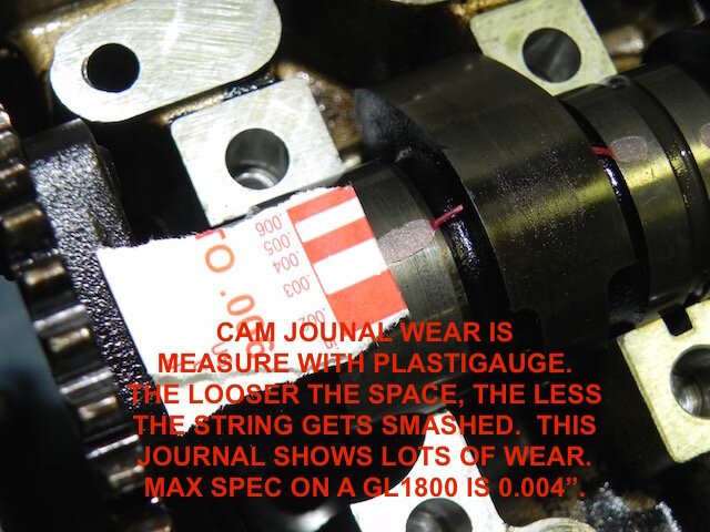

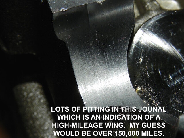

Below are pictures of normal wear on some cam journals and shows why valve adjustment is needed.DSCN5704.jpgDSCN7257.jpgDSCN5707.jpg
Plastigage is a special, precision, waxed string used to measure gaps.
A new Wing's valve journal gap is around 0.001". The above wear happens from use, how it's used, and maintained. Frequent oil, oil filter, and air filter changes slow down such wear.

You show pictures of a high mileage journal with lot of pitting. You label it Normal! Is there anything that could have been done to prevent (help lessen) that? Was this journal reused when the bike was reassembled?

As for "normal" wear in a cam journal. I believe the picture with all the pitting came from a head that was not reused. I'm sure it came off the fastest GL1800 running the Gap. In that head's case, it came from an extremely well maintained Wing, but one that road hard. It had oil and filter changes every 4k. Air filter, brake and clutch fluid every 12k. The guy who rides that Wing is on the ground inspecting it prior to riding for the day. Air pressure is adjusted daily.
The head had a hard life for it first 75k, then the rider started perfecting his riding skills to become the fastest riding a GL1800 on the Gap. To be the fastest requires running in 2nd and 3rd all the time at 5500-6500rpm. A set of tires lasts him about 1,000 miles. To me that journal falls in an extreme use category ... thus all the pitting and a Plastigage reading of 0.003". That same head on your Wing or my Wing with 150k would show less pitting and would Plastigage out at probably 0.002", and it would probably be that way easily past 200k.
