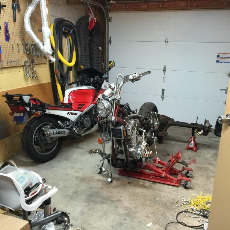

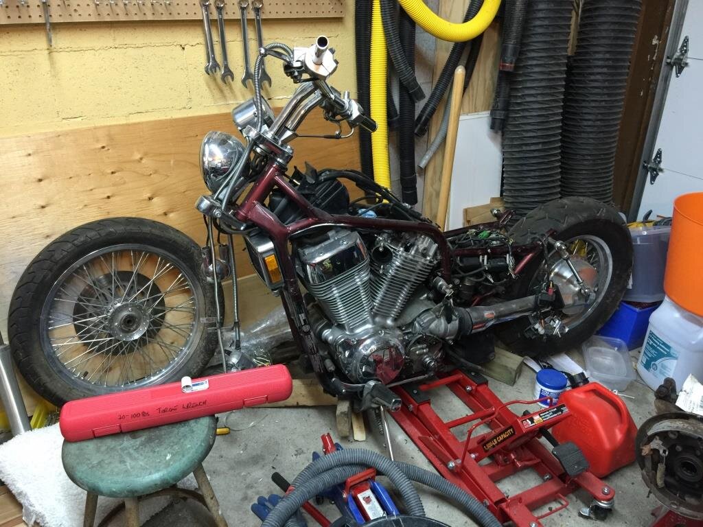

The bike and the differential, I just noticed it's a 2:73 ratio, anyone know the final ratio? the original bike ratio is 2:33. The tire height is 29". I chose this rear end because it had the closest gear ratio to the original.
The bad part about it is ,the pinon is on the wrong side of the ring gear. u can run the car rear upside down for the proper rotation .I think its been done like that, but u have to watch the oil level. U can get gear sets from summit raceing equip . 8.8 popular rear end.
Thanks Pepper, it would be a real interesting ride if it only went in reverse :xzqxz: I was told by Loner to plug the existing breather, flip the axle, re-position the breather and keep a higher viscosity lube because less of the ring will be in the oil. Sound right?

View attachment 24387View attachment 24388The bike and the differential, I just noticed it's a 2:73 ratio, anyone know the final ratio?
