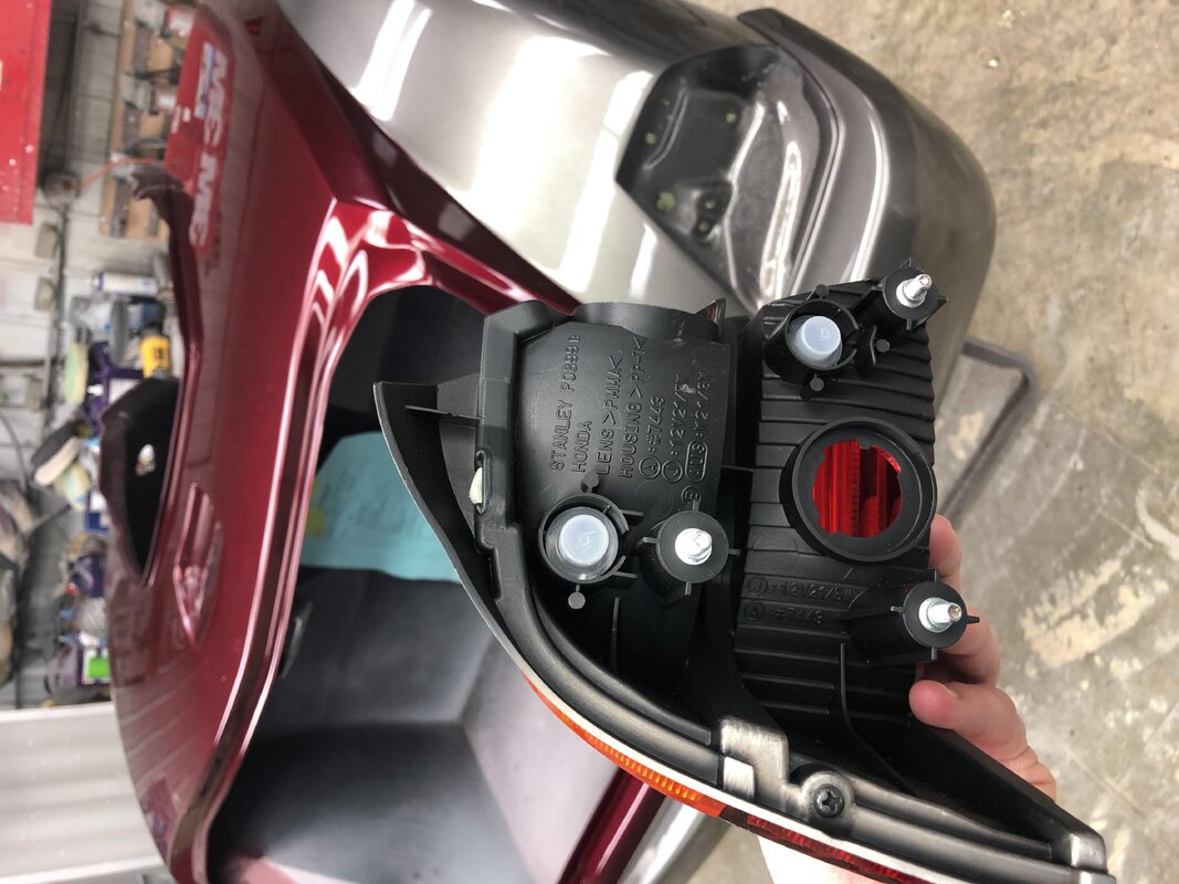

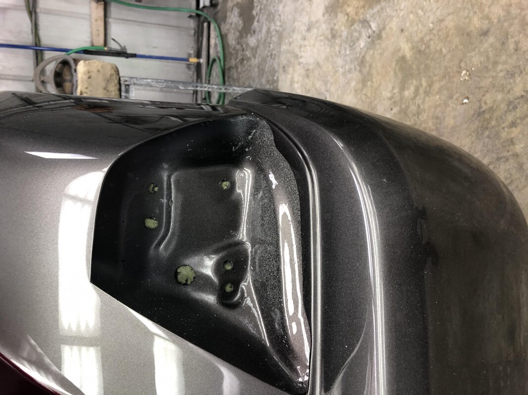

Burnerboy - sorry for not responding in a timely fashion. I do not think you actually have water in your lights (maybe...). I suspect what you are seeing is water trapped in the housing (where light mounts) behind the tail light lens. I'm going to post a couple pictures of a light along with the housing.

I just read your post and saw your pictures.............Aaaaaaaaaaaaaaaathat wonderful news to hear, thank you very much for your return comeback.... Now that you mentioned this I will go out and check, BUT I now believe your correct................ That's good news, I was afraid to ride in rain, and blow all my lights....
