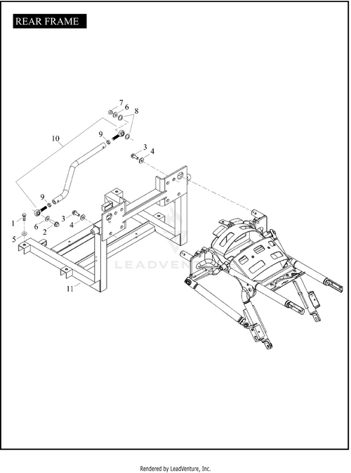

Shake the body side to side and listen for clunking sounds
#10 is the rear trac rod, it tends to make noise when wearing out the rod ends

Depends on mileage, I wouldn’t worry about The cam chain tensioner if it’s under 75000 miles, I changed mine at 72000 and they looked like new. Compensator i would ask if it’s been replaced.they can last a long time. Shocks will suck, reverse motor, if it works a few time you might be good for a while. Might just need to rebuild the motor, I did for like $75. It’s a starter motor. Side to side, clunking . Might be the panard bar or the shaft bearings. Get a Service manual and a trike manual.
