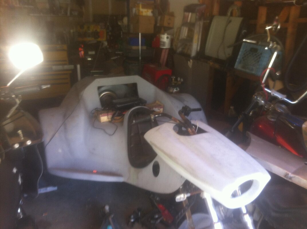

Understanding everything is a huge ball park wanting to know roughly where I should start with this trike to get it sold.
I am the second owner my grandfather was the original person to order it. I have every form receipt and every part accept the trailer some of it still new in the box like the fairing and and rear storage box. It was purchased with the rebuilt engine and transmission as a running kit from what I can see but then the trike sat in the paint booth of our hanger forever the body was actually outside for years the gel coat was ruined from sun and the glass broken across the fenders. I never really knew what it was until I found the paperwork one day with the pictures on the brochures.
I dug everything out of the paint booth and started to rebuild it. Currently it runs perfect has perfect compression alternator conversion, disc brake conversion with emergency disc brake (borrowed from gm thanks) currently rebuilding the factory springer and 18 inch wheel and will probably sell it when its finished and road worthy.
I have more pictures just put the one on figuring the guys who know will know and can lend a hand.
Should there be a front brake? There was an option on the order form and a 4 inch drum in the front wheel but this one had a cover over it. Next question is do I want to put one on there? not a trike guy so I dont know please inform. I am a machinist and can make what cant be bought however.
Any info you can offer would be appreciated I see the company has gone out of business
Thanks Tony

You've got a real classic there. Should be attract a lot of attention when you get it done.
Front brake - that depends on were you are from. Some states require a front brake, some dont. VW trike front ends are usually pretty light, (You'll see quite a few with wheelie bars.) and the front brake doesn't have the stopping power like on a 2 wheel motorcycle.
As for the value of the trike as a whole, condition is the key. Runs great, good. Looks good, great. Both - that's where the value is.
BTW - You say you're not a trike guy. So might this project turn you into one?
As Ozark stated, it really depends on the finished condition. Most of the ones I have seen go anywhere from $1500 to $5k. Of course it depends on the condition again.
Also, as Ozark stated, the front brake needs depends on the state. I wouldn't worry too much about building one if your just going to sell the trike.

All4Cams,
Please share a bit of basic info on your trike project:
- How was it, or is it to be registered? (VIN Plate? Manufacturer? Year, Model? First registration as 'homebuilt'?)
- How will it be conveyed to new purchaser?
- Motor type info? (Year, dual-port, single port, years/miles since rebuild?)
- Transaxle - swingarm or IRS?
- Missing any OEM components?
First look for me it appears to be a Stires model (as opposed to the half dozen other manufacturers that offer(ed) similar body styles - Wilmac/Arizona/Lithia/Trike Shop,etc.). Key evidence to me is mention of 'springer' and '4-inch drum brake on 18" wheel'. Stires was the only manufacturer to offer that combination as I recall.
Definitely a good move to restore the original springer and get rid of the big hydraulics in the photo. (Why 'rebuild'?)
Anywho, these basic bits of data will help in considering a value. Also, may I assume Fairfield is in CA?
