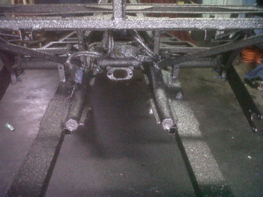

Fowler, do you have any drawings or pictures of these that you made? I'm seriously thinking of doing that to mine. Since I built the 1835 I have to be pretty careful not to do wheelies. :laugh:
Thinking of doing that and installing a hitch. I could probably incorporate both int he same design. :clapping:
I can see that you have them attached to the torsion tube and running down the wish bone frame. How did you attach them to the frame rails?
At any rate, that is about what I want to do. I see you incorporated the hitch much like I plan to do.
I'm not sure what you are referring to as the frame rails
Basically they are as you stated welded to the torsion bar tubes and all the way down the wishbone.
I used thick steal and a few other welded supports in places I thought needed it.
I had to change their angle at a certain point to bring them to the correct height and level I wanted.
The wheels I picked up at a Tractor supply store. I do not remember the weight limit on them but I do remember they were way over rated for what I figured I needed
