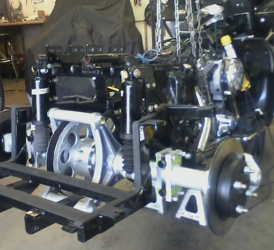

here is some pictures of the trike backend i made for the xj650 trike (duo shock setup)
Since I put a Champion kit on my Road Star 1700 myself, I might help enough to get you thinking. My solo shock is ahead of the swing arm. They kept it and added 2 coil over shocks between the axles and the upper frame which is a extension of the rear fender and seat frame. Check the instructions on their site to see what I mean. http://championsidecars.com/wp-content/uploads/2016/08/road_star_trike_guide.pdf
(the blue part is what the shocks attach to)
Good luck
Good luck
Thank you very much it has got me thinking how i can exactly do it
Thank you
ive been told that with me usuing a reliant axle that 17" wheels would be best for gearing purpose
i am hoping to get a day on trying to make a frame for the dual shocks to fit (UK weather isnt best)
i appreciate all the feed back from you all as its helped me alot
