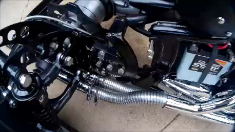

With the research, and general information I was able to find using my Google Fu, I found out that the Tri-Wing kits require you to cut your drive shaft, weld it inside of this coupler they send you, and pretty much it.
If they would have sent me that picture, I may have done it. But they refused to.

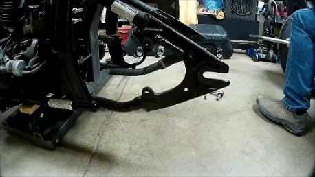

Sent my $$$ to Tom, tore my Swing arm and final drive off my bike ( they need it to modify it to the axle they will CNC cut and build to it), and sent it to them to be converted.

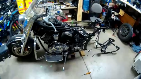

Pics of the tear down:

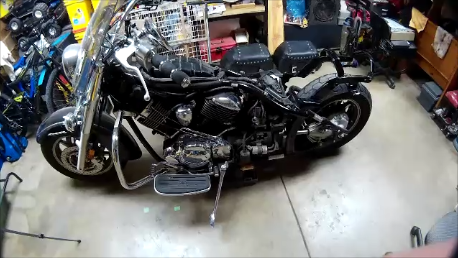

Pic from last Fall2015

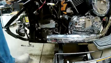

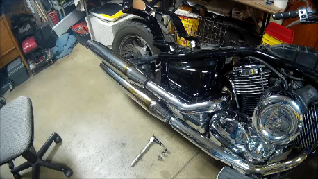

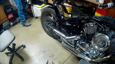

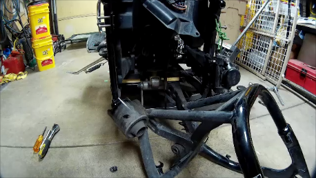

Start to take off the saddle bags and seats.
View attachment 34915 Starting to remove the stock mufflers.
Pic of it from left side.

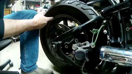

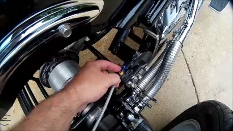

Start removal of the bar for the saddle bags, the Rear disk brake caliper.
Make sure to hang disk caliper by a wire or other such, dont want to just hang it by it's hose...

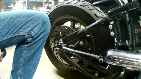

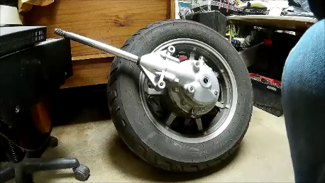

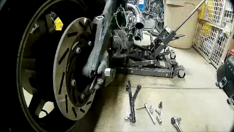

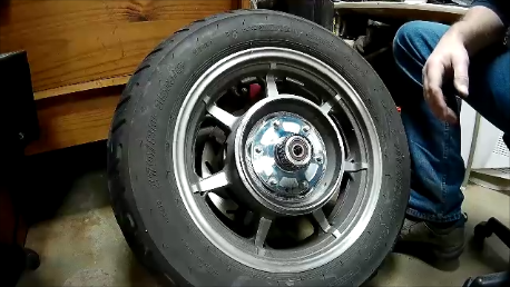

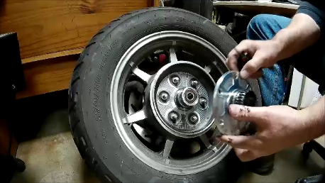

Pic of the two nuts holding the right side of the rear axle.
Removing the bolts to the final drive.
Removing the 2 nuts for the axle.
Sliding wheel and final drive off the swing arm.
Remove the final drive assembly.

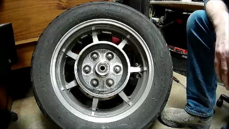

Remove the nuts holding the final drive gear from the wheel.

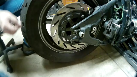

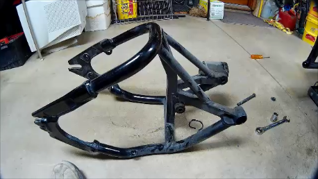

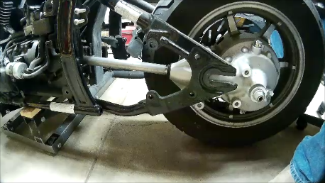

Had to remove the rear exhaust manifold to get to the bolt for the swing arm. also the battery, and battery box.
Pulling the Swing arm off.
Inspecting, for just under 7000 miles - still looks new :)

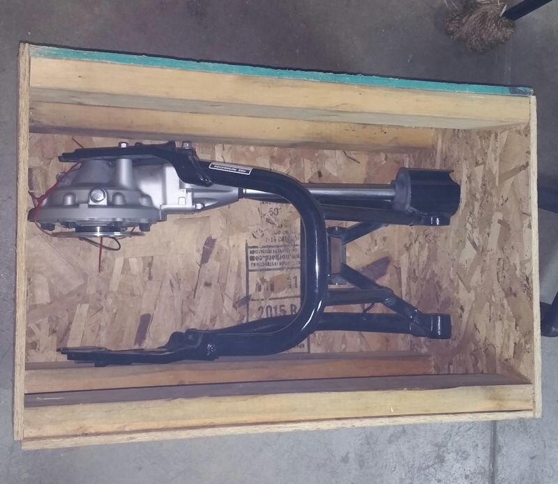

Re attached the final drive differential and final gear drive gear - to ship off to be converted to the trike axle.
Built plywood crate for it...
Needs much more padding - filled it with old news papers.

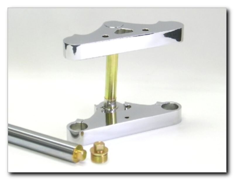

Been looking into this "triple tree rake"....the ones making my kit "recommend" a 5 degree rake.
Damn! These things are not cheap, either!
I am not sure if I need or want one....
From what I have been reading, alot of people say they are like adding "power steering" to your bike.
Other say, if you cant handle turning maybe I should get a car....lol.
So, armed with the little knowledge I have gleaned from this forum and my google Fu...
I found that on my stock bike it has a 32 degree rake already.
measures from frame to front axle 19 inches.
with a trail of 5 3/4 inches.
Adding a 5 degree rake will make 37 degree rake, 20 inches from frame to front axle and a trail of 6 1/2 inches. at a cost of $700 plus.
Adding a next size up tire adds almost the exact same, for a cost of about $160.
Is the rake worth it?
I found...If I do this...I like the looks of this one:
zzz.jpgEliminates the top nuts, makes it look much "cleaner", and has a "built in" 1 3/4 extension.
I think I will be waiting until I get the trike completed - [tighten up the front tree's as suggested], ride it...see what I think.

i think you have that backwards.... if you add raked trees it move the wheel forward but reduces the trail not increase...
i think 5 deg will make more than 3/4 in difference...
imho the reduced trail is the ONLY way to go... like driving a dump truck w no power steering compaired to a vw with power steering.. i think you would be pretty happy with the 5 deg tree..
I don't sell a rake kit for your bike but the one you posted looks like a good quality piece. No, adding a taller tire/wheel on the front wont have the same effect as raking it, and yes raking it 5 degrees will make a big difference in ease of steering. You can always finish the build and try it without the rake but I think you will find that you will want to add it.

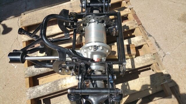

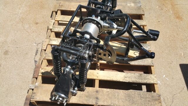

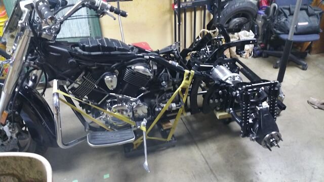

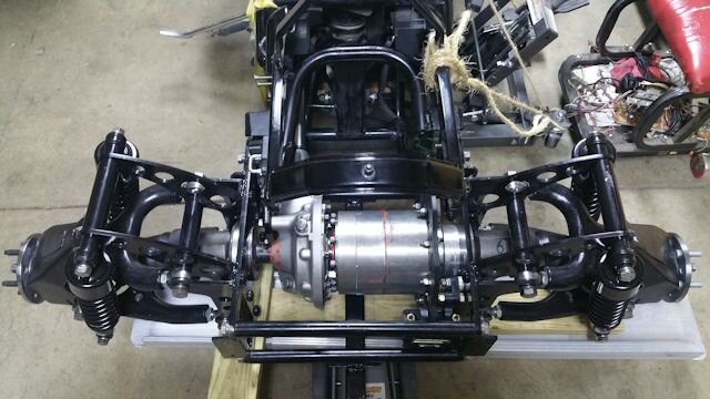

Only 6 weeks to arrive, after they received my swing arm for conversion.
After removing all the shrink wrap, and setting the body off to the side.
Opposite view

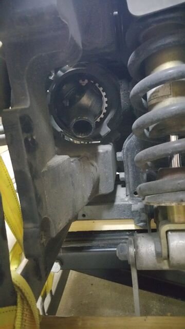

One of the 1st "issues" I have found.
Looks like they had to "modify" the mount - using a cut off wheel grinder...
I have nothing against "RVT", but, when you get it all over your hands, gloves - go wash them, or change gloves!

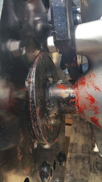

Also, you will see my next "issue". The axle "hub" is...a little crooked. :Shrug:
I was advised by American Trike / Extreme Trike, that there is a bearing inside, and that it is straight, and shouldn't be an issue.
Um, okay....yes, I will be checking and watching this through out the build...

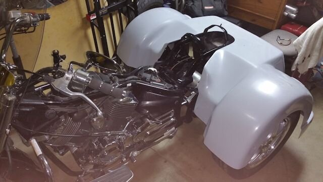

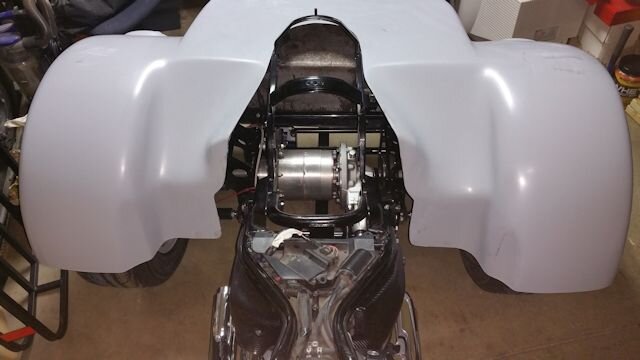

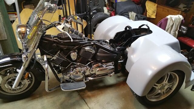

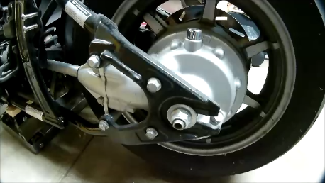

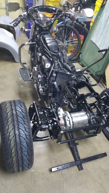

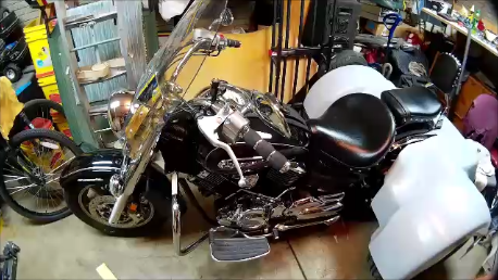

Checking the alignment for the drive shaft

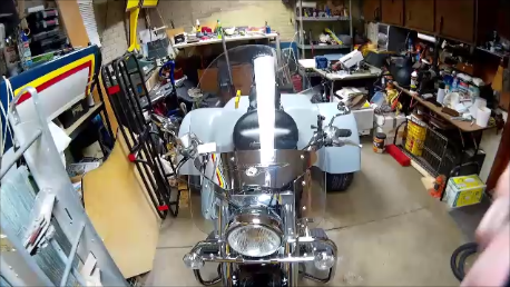

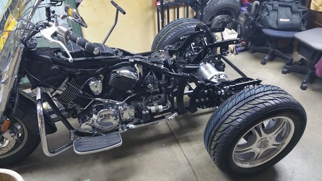

"Test" fitting to the bike / Trike.
Checking side to side and centering.
looks good, so far.

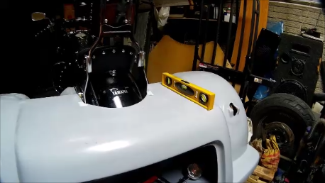

Now, I'm just waiting on wheels, then can mount the body and trim to fit.
Then send out for paint.
looks good, so far.
So, as you can see from my previous post, I have a bit of "cleaning up" to do.
Then Paint.
Then can get back to assembly of this.
No instructions, no pictures - lol Just gonna have to "figure" it out...
Anyone have a "starting point" for the preload on the rear axle?
Think I saw somewhere to put a 1" thick board under both rear wheels,
Loosen all bolts,
Use a floor jack to "level" the trike - mostly the oil has to be "level".
Then tighten everything back up.
Sound right, or close?
really sad to see a new pc like that show up w rtv all over it ... a little modification is not uncommon but be nice to make a "finished" pc.. if ya know what i mean
^^I completely agree.
Yes, I can do all the needed machine work, clean up and re paint...But, For what I paid - I shouldn't have to do it :AGGHH:.
Okay!

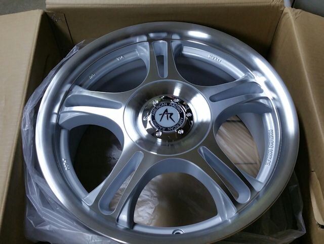

I got the rims in today!
Wanted to upload some pics of my "progress" : )

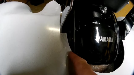

The "T" bar that the body mounts to...all 4 holes stripped out. Looks like they "tried" to clean out after the powder coating...
I got that cleaned up : )
Starting to "look" like a trike now - !
1st TEST fit of the body :clapping:
Trying to center it up.
I need to mount the fender, measure and cut it - to make room for the body.
Then, trim the body to fit.
And...Then off to paint.:D:D
I'll still post up the next pics as I get to them, New cobra ShotGun pipes, and mounting, carbon fiber covers...
