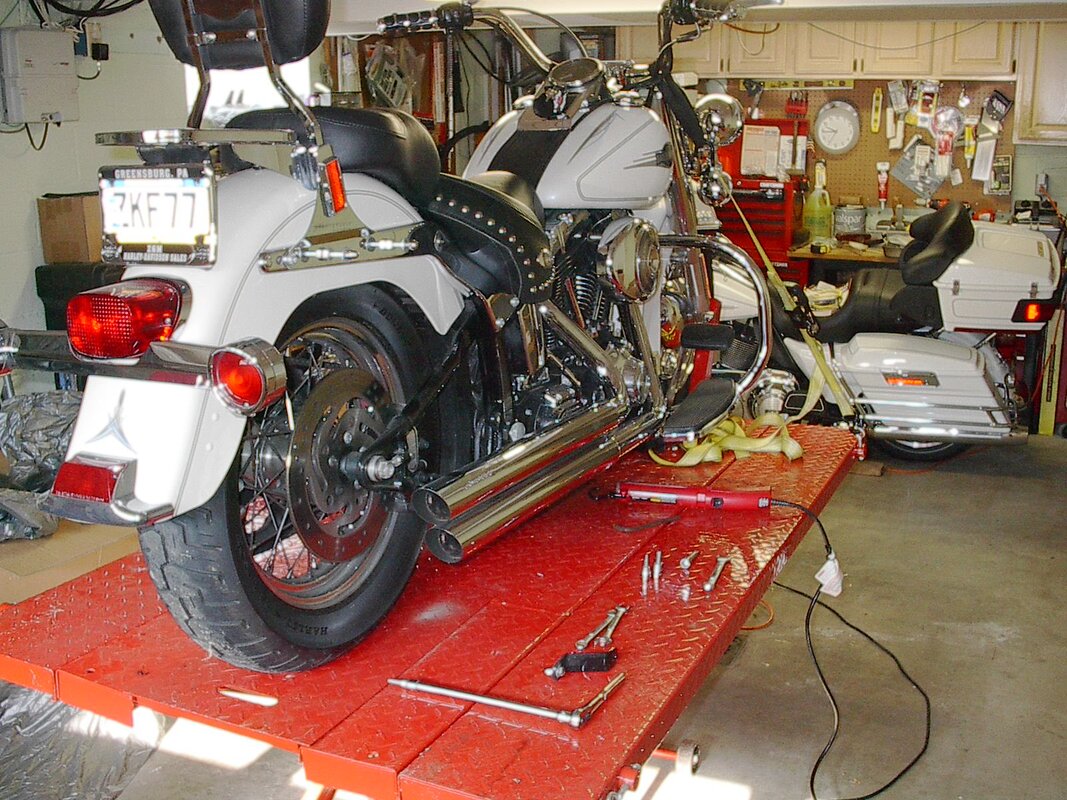

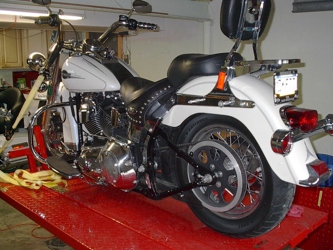

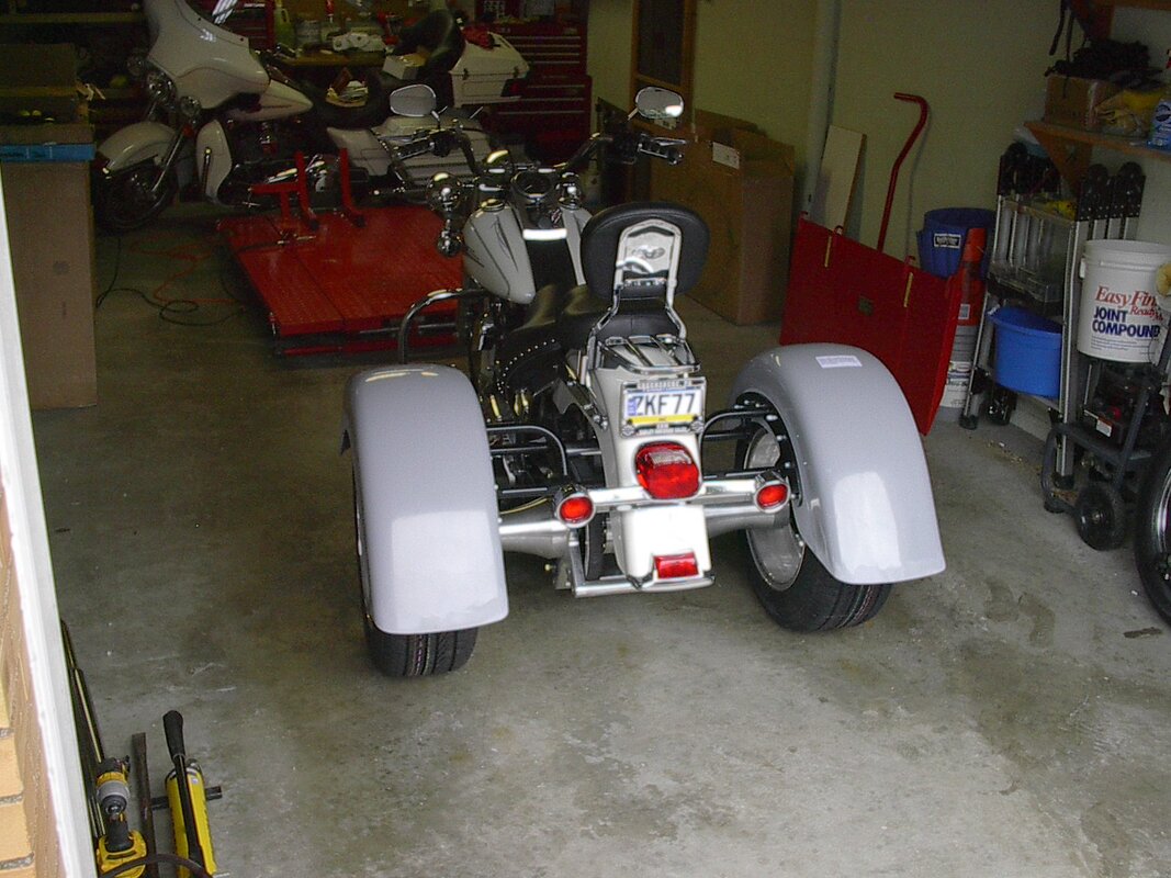

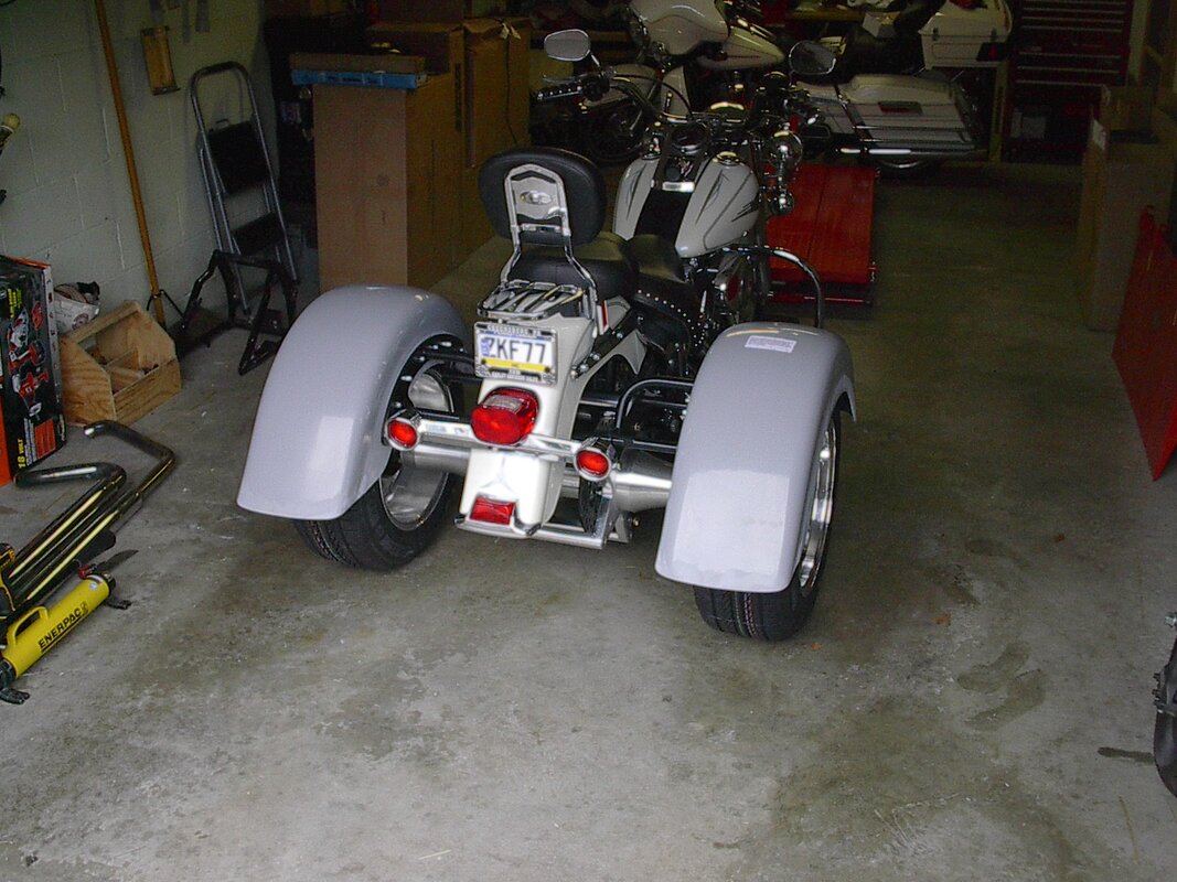

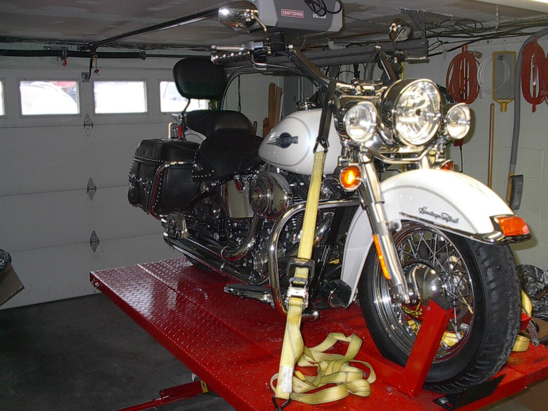

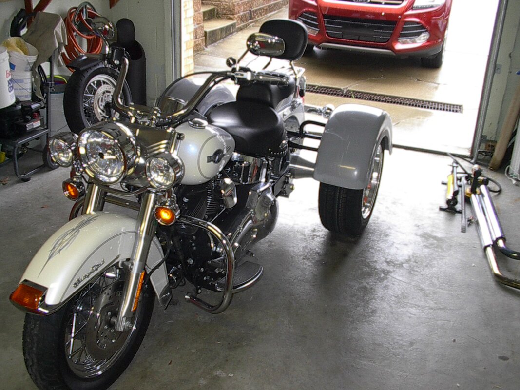

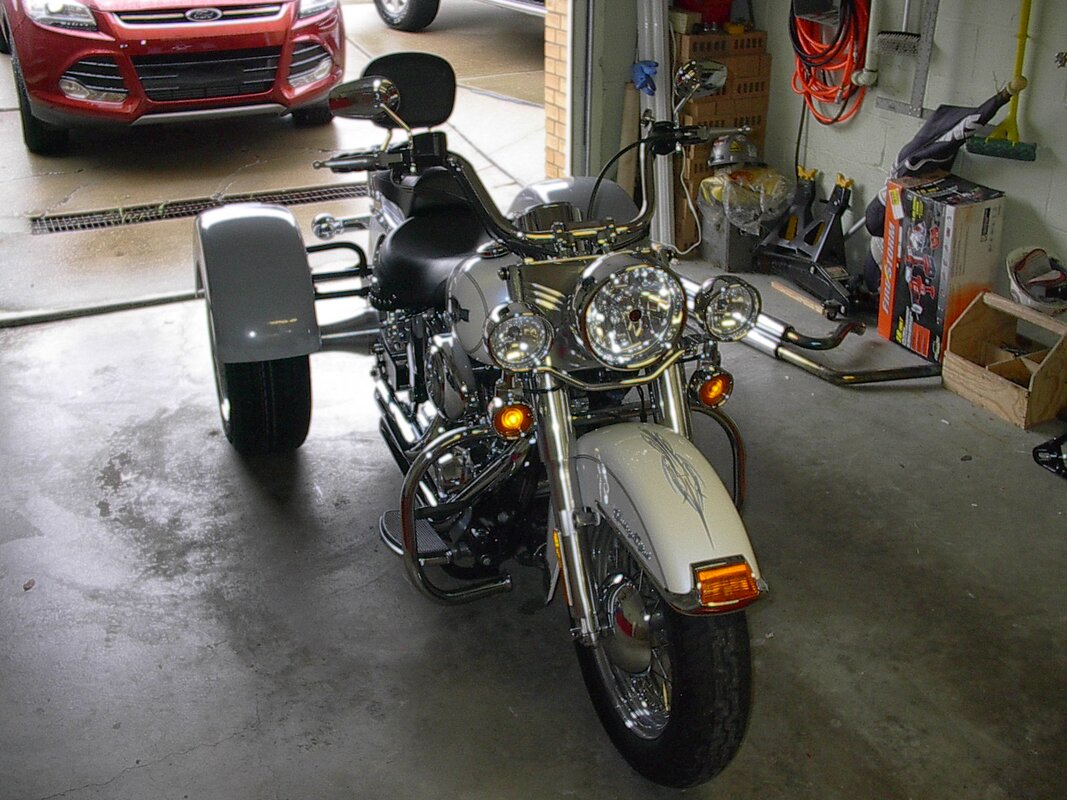

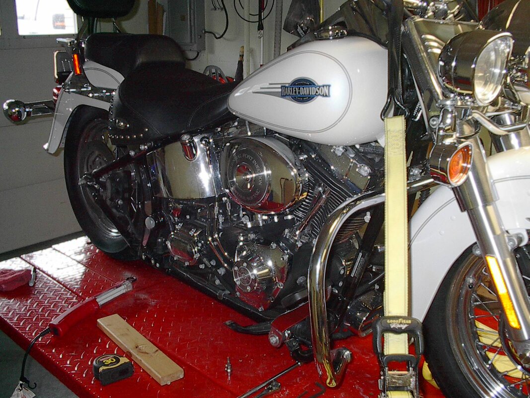

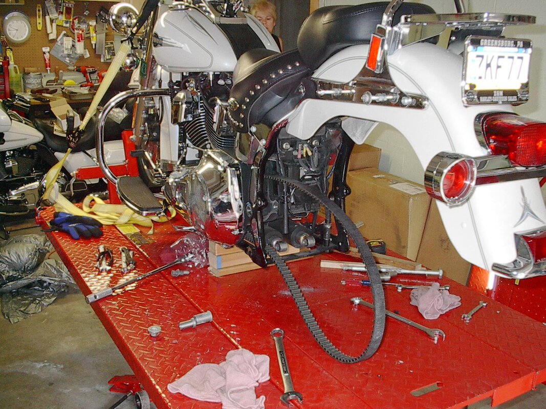

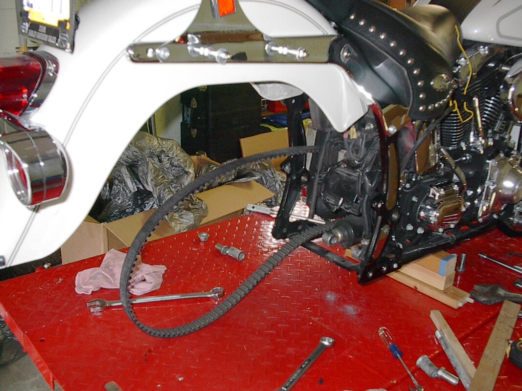

And the end result. Still need to do the rake kit. And need to get plugs for the 02 sensors in the exhaust.And get paint on the fenders.trike build 4 001.JPGtrike build 4 002.JPGtrike build 4 003.JPGtrike build 4 004.JPGtrike build 4 005.JPG
Nice trike and great pics! I did a Champion kit on a Sportster recently, it was fun doing the work and watching it all come together. Ride safe.
Looking Good! you might want to holler at Bazooka when you get rady for rake kit. Probably can help you out. RIDE SAFE
I received the rake kit from Frankenstein when She bought the kit. It just needed installed when the pic was taken. I told her to get some snow tires for it since winter is almost here.

Getting her Trike ready for the riding season. I changed the baffles in the short shots to there quiet baffles. Made a nice difference in the tone, now the sound is deeper and not so overpowering. And the plus side is better throttle response and power.

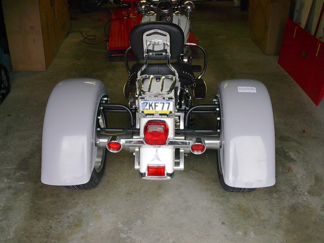

You can't use the stock saddle bags, due the the bracket used for the rear fender mounting.
So I bought a T-Bag and mounted it on the luggage rack. If you don,t use the rear fenders the original bags will fit. I have a set of throw over saddle bags that I may try to modify to work.
