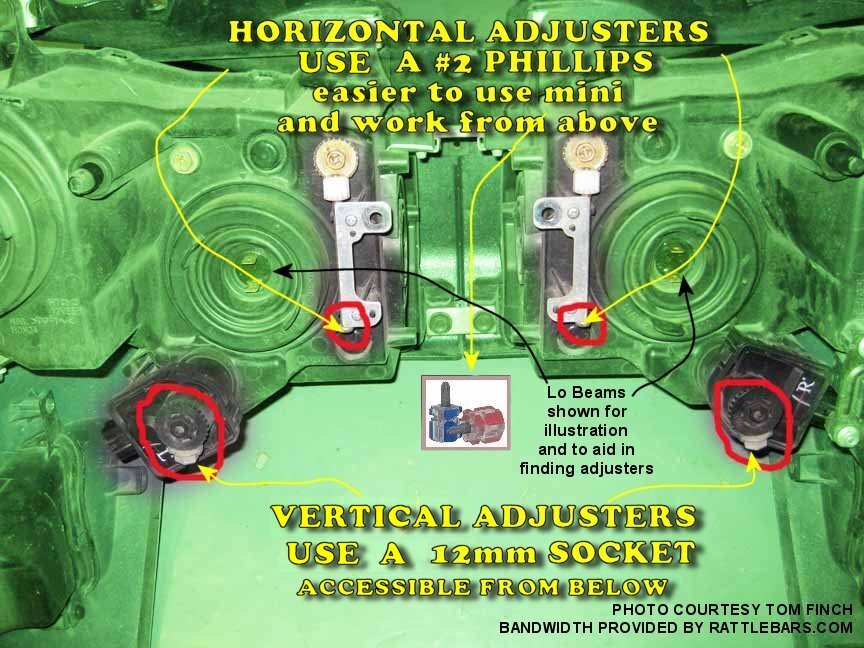

Yes, there is a mechanical adjustment. I had to do the same thing on mine.
If you look up under the front cowling you will see two adjustments on each side. One for vertical and one for horizontal, don't remember which is which. One takes a phillips screwdriver the other is, I believe, a 10 or 12 mm socket. I use to have a picture of that, but can't find it.

Turn the horizontal and vertical manual adjustments (Under the front cowling) to place the low beam where it should be. I placed mine about two inches below the mark on the wall. (Note: I had to cover up the headlight I was not working on to see the one I was working on and when both were adjusted, made fine adjustments to line them up.

Use the manual adjusters accessed under the front of the fairing.
Adjust the vertical until the hot spot of the upper beam bulb is just under the horizontal line on the wall.
Adjust the horizontal until the upper beam hot spot is just to the right of the vertical line on the wall.

How do you get to those adjustments? I can't imagine you need to pull the whole nose? I just had mine mostly apart and couldn't get to those ... LOL
Hmmm ... maybe that's why the little piece in the middle bottom of the nose is there?
You access 2 of the manual adjusters behind and from underneath the fairing using a 12mm socket and 2 from above behind the fairing using a #2 phillips screw driver. You do not need to remove anything.
