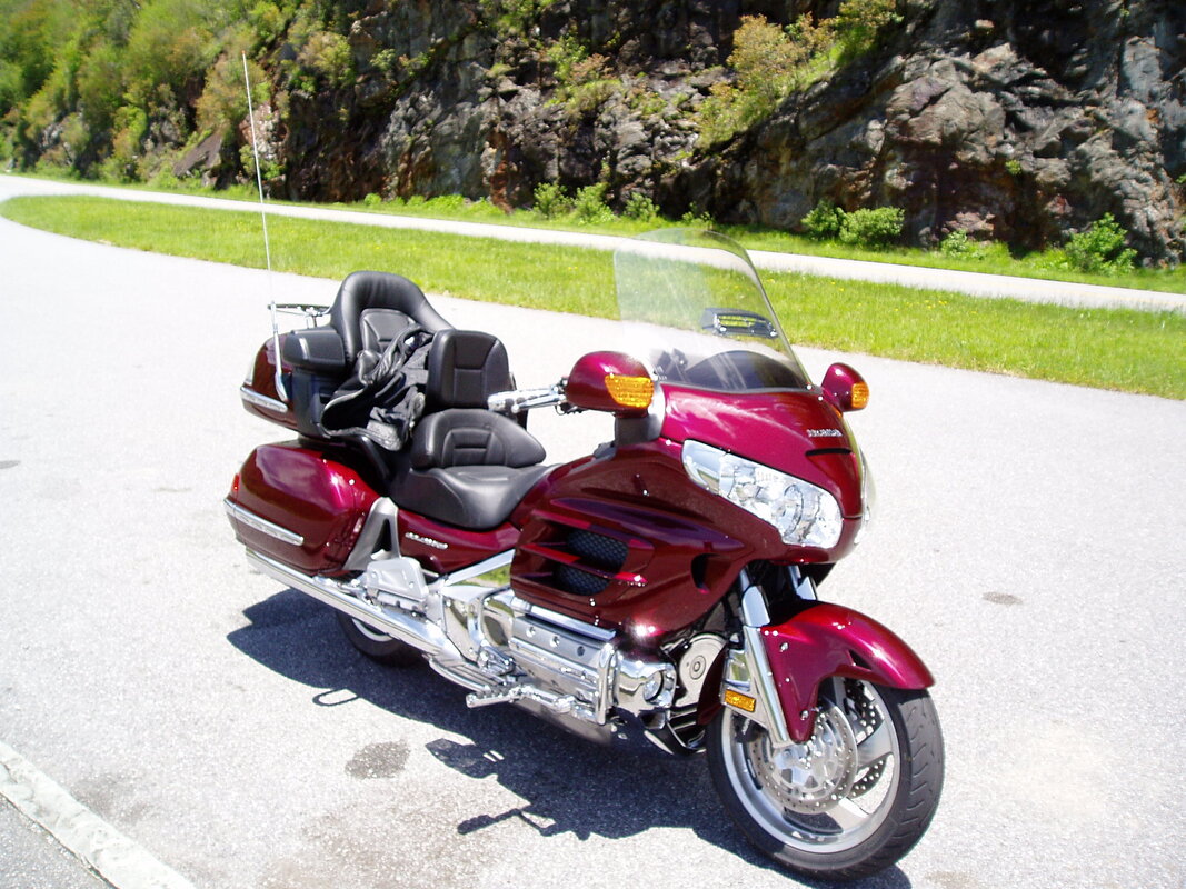

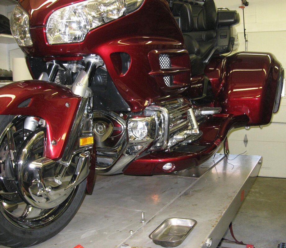

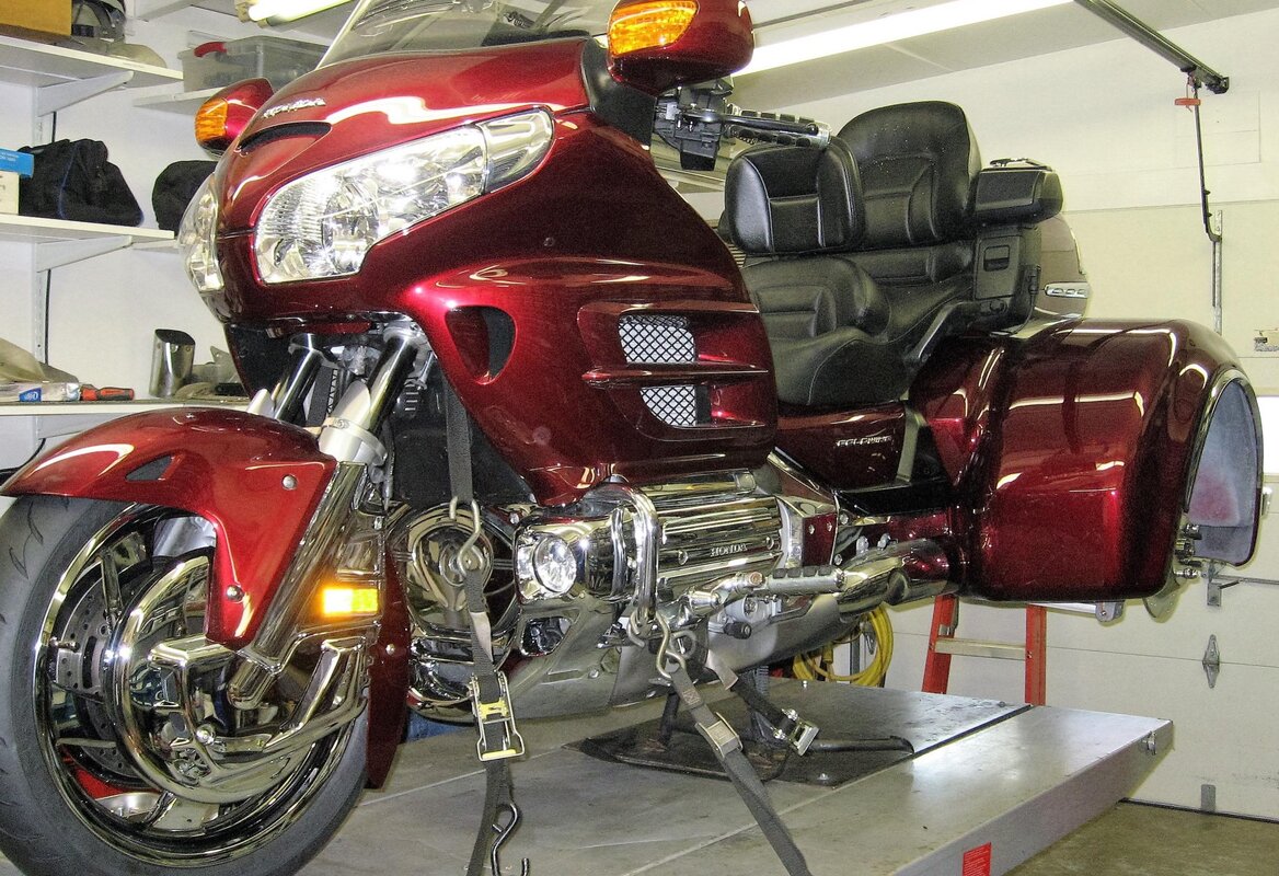

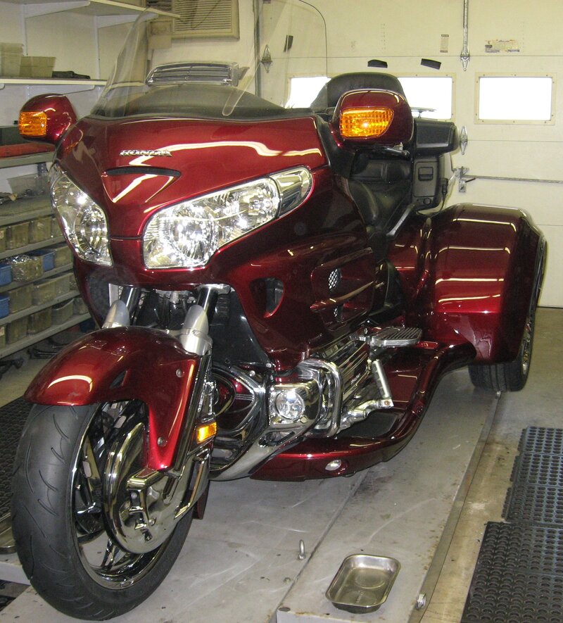

Let's start with a couple of "Before the Conversion Build" pics.
This pic is taken at the Gary's covered loading/unloading area.
Here is another final pic as a two wheeler.

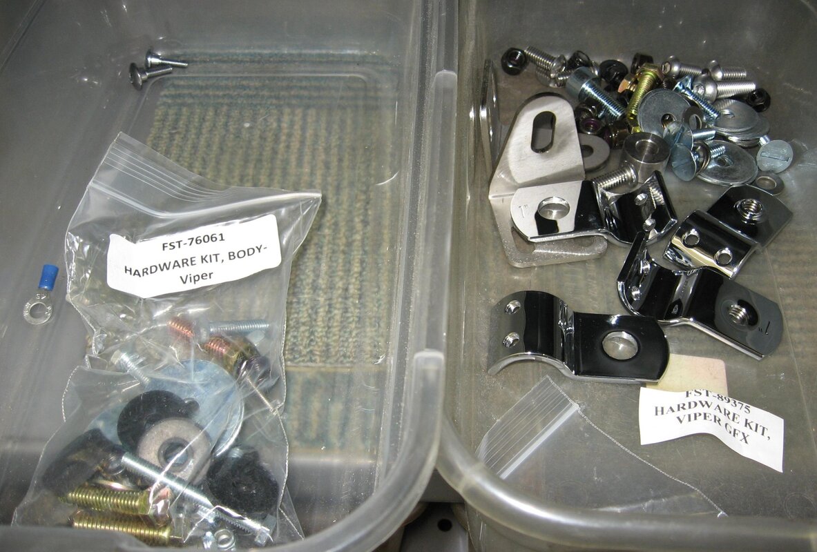

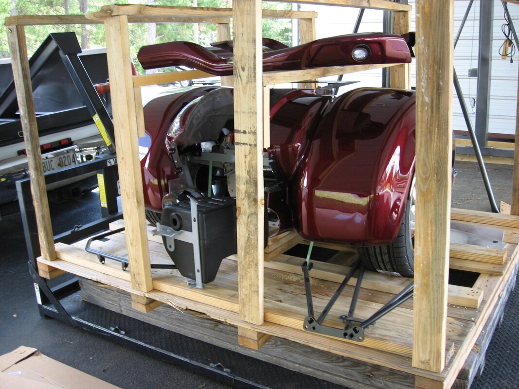

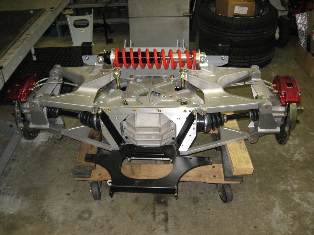

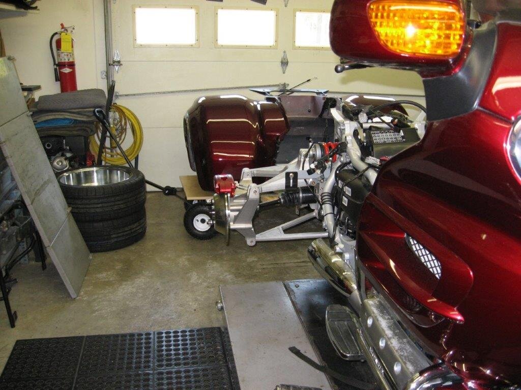

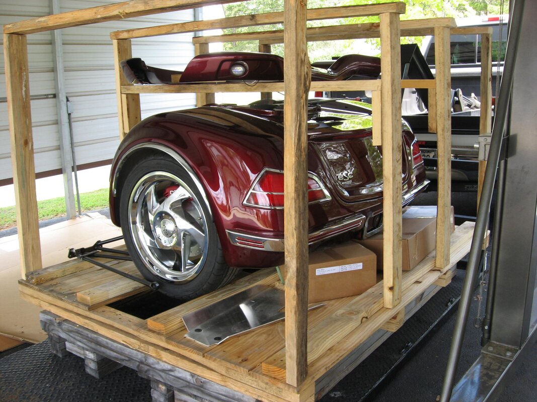

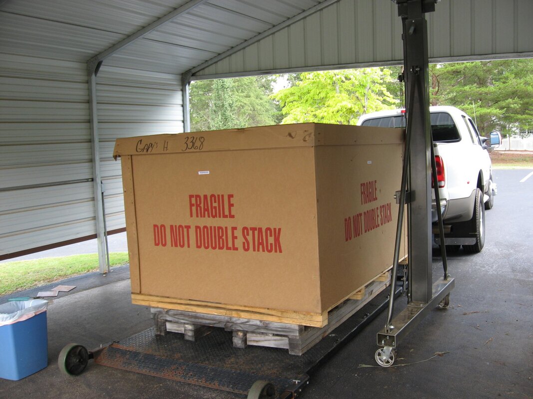

The next 4 pics are the actual delivery and uncrating of the conversion kit at Gary's facility. Gary will take delivery at the truck delivery's distribution center. He will then unload the crate with a hoist in one of his outdoor covered receiving bays.
Note how carefully CSC crates the equipment and the accessories. After uncrating, Gary carefully inspects each piece and takes inventory of all parts and the accessories.
Gary maintains excellent communications with me on the status of the build and keeps me well informed of the progress.ThumbUp

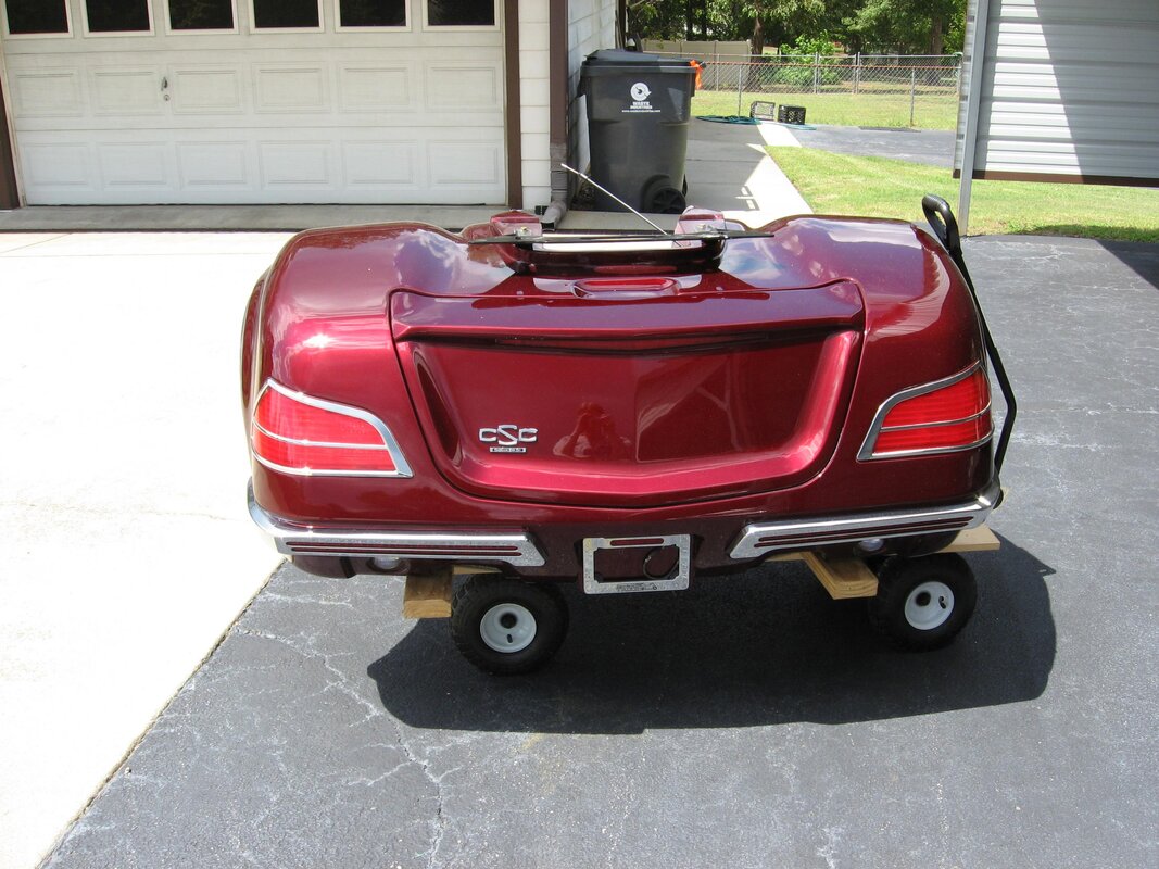

The next 2 pics show the chassis uncrated and then the body loaded onto a wheeled dolly headed to Gary's shop.

As you will soon see in later pictures, Gary, the trike builder, has installed a chromed directional wheel on the front as well. Now all three wheels will look the same.
The front wheel has Centramatic Wheel Balancers mounted on the rotors. Gary plans to use chrome rotor covers to hide the rotor areas.

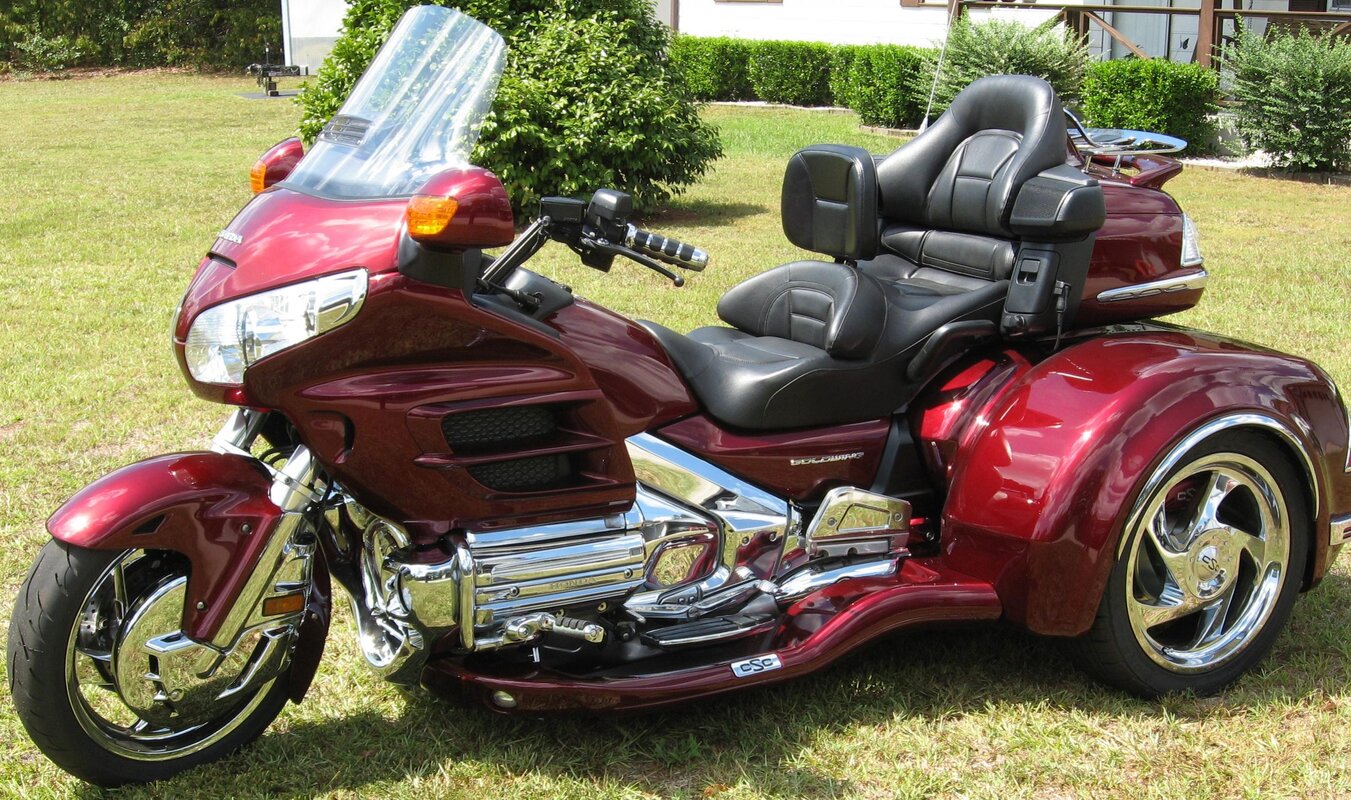

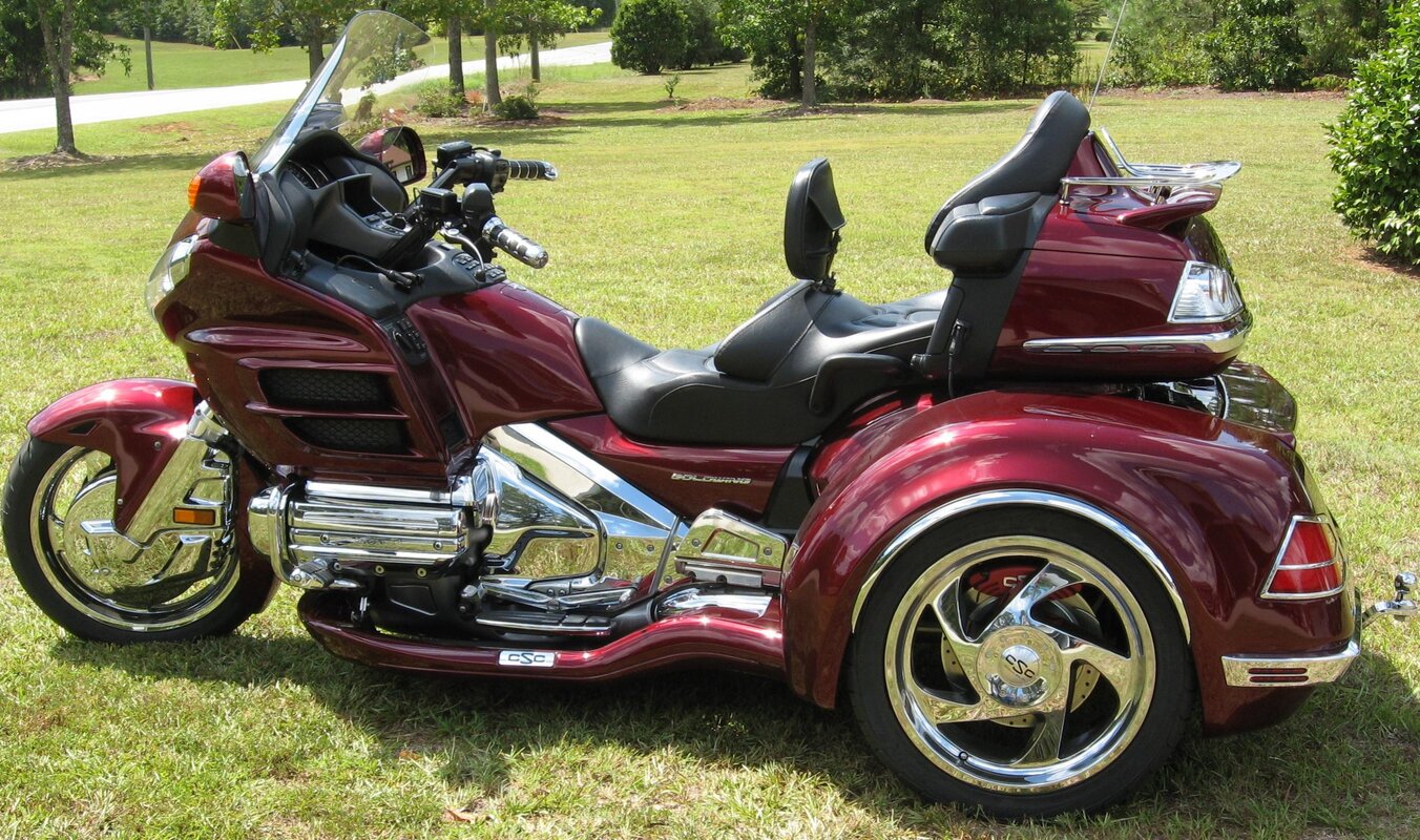

The only thing better is actually getting to do the conversion yourself... I didn't have all those fancy lifting toys so I had to enlist some help to muscle my create round. Thank God the Old Dominion deliver guy and I got it from the street to my truck's garage without too much trouble. Getting it uncreated and moved to my motorcycle shop was a walk in the park. I didn't have the forethought to chronicle the uncreating. Boxes on the left held Wing Guards and assorted parts.
Here is about half way through.

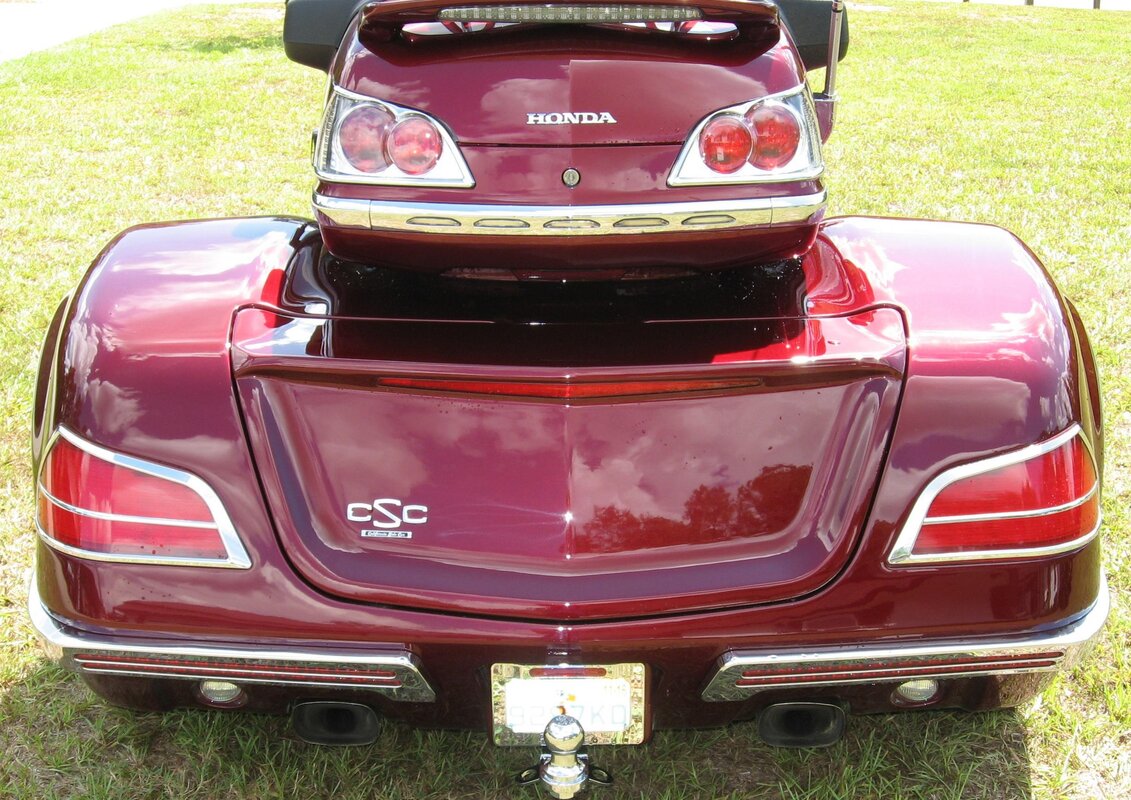

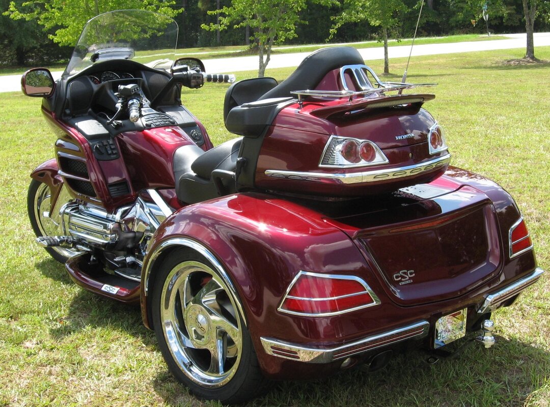

And of course you know the finished trike.

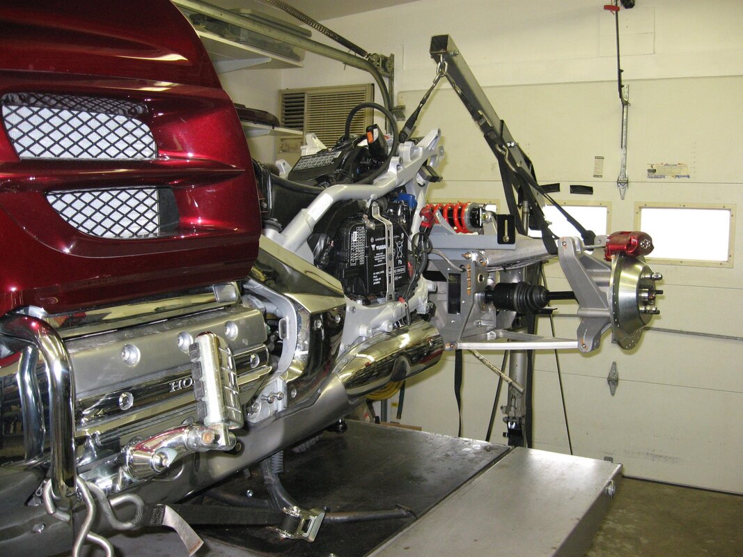

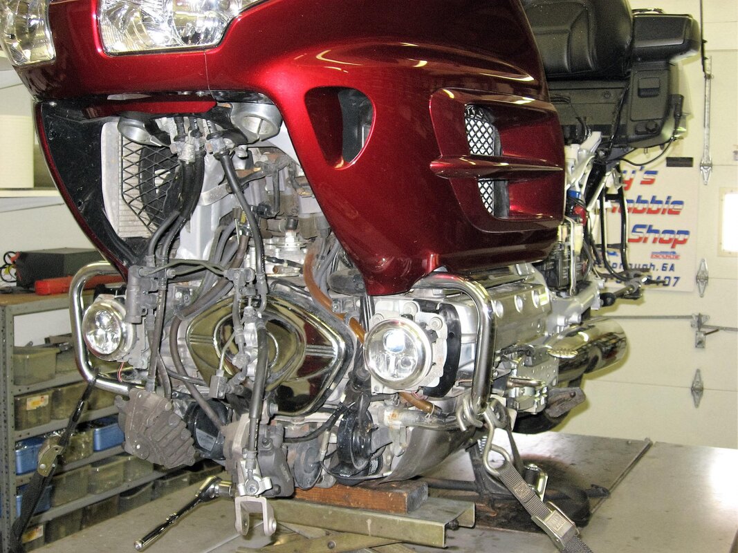

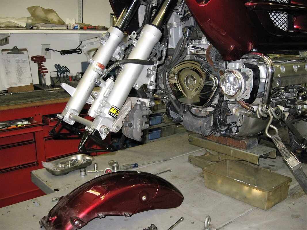

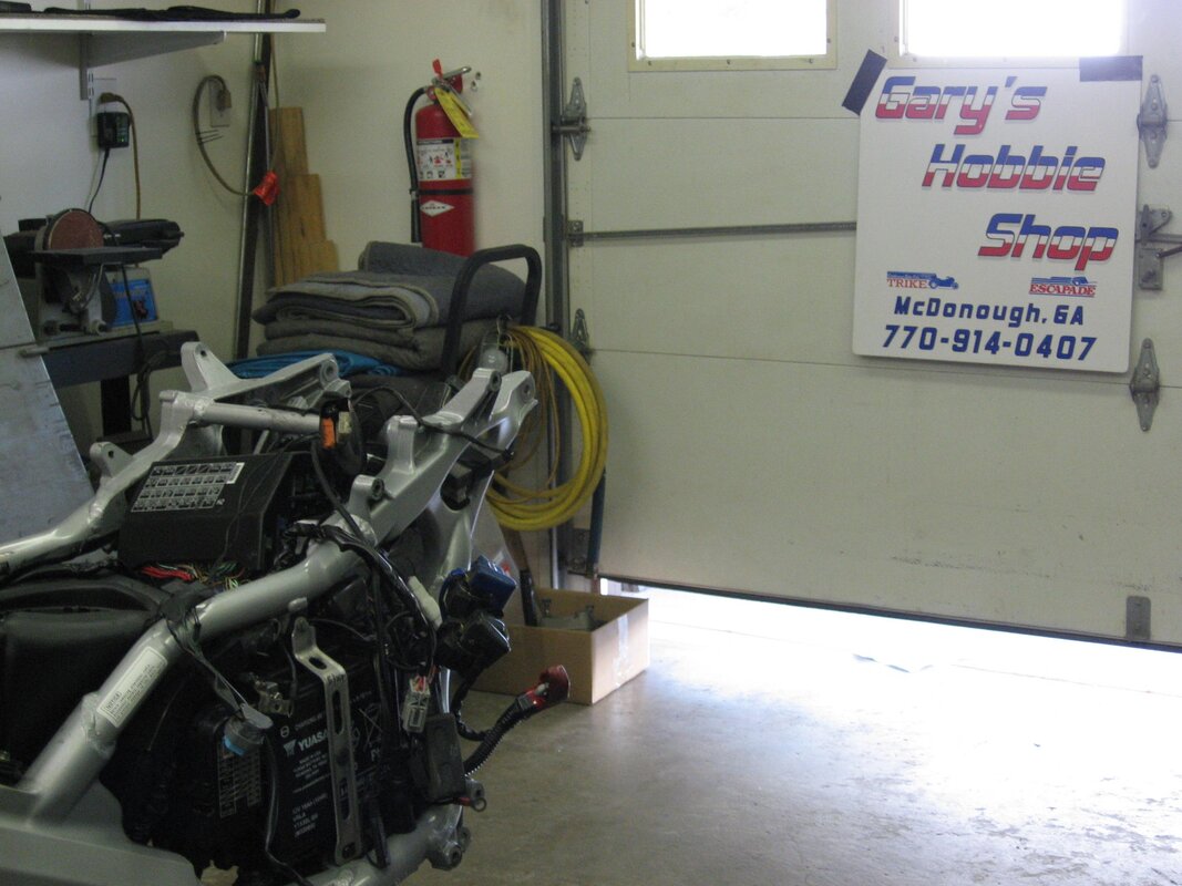

During the fabrication phase of the CSC conversion kit, Gary kept busy with all the maintenance work as I described in Post #1. The front end of the bike is stripped and prepared for the 6 degree rake kit. The Traxxion AK-20 fork cartridges are removed and then sent to Traxxion Dynamics for a complete rebuild.
Gary now installs the 6 degree rake kit and tree. He then reinstalls the rebuilt AK-20 cartridge tubes and forks. Gary also replaces all bushings and seals at this time.
Gary now installs a new Avon Trike tire on a chrome directional rim. He also replaced the wheel bearings. This is the stock directional rim that has been chromed. Gary will replace the lower front chromed cowel . The old one was badly pitted. Gary then mounts the brakes. He then mounts a "painted to match" front fender extender. The handle bars will have a MBL riser added to bring the handle bars back and in without changing the throttle cable or any other lines. We now have a completed front end.

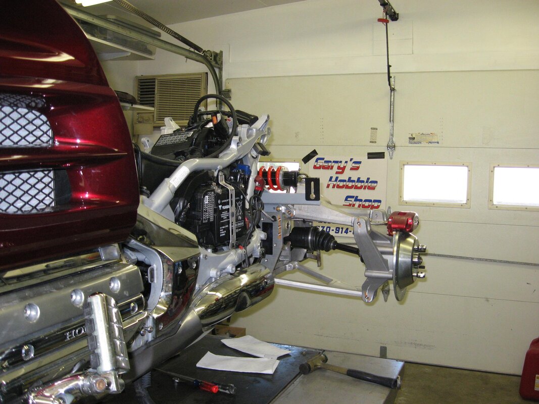

Gary completes a trike conversion from the front of the bike working towards the rear. As his work progresses, he utilizes a "check-off" list that he follows every step of the way. The list is extremely detailed down to very nut, washer, bolt and connection required for a complete trike build. He will sort all the required small parts and pieces into work trays. Each tray is clearly identified for the intended use.ThumbUp
Also at this stage, I opted to replace the 97k mile alternator, instead of rebuilding the original, with a Mitsubishi OEM. Gary indicated to me that this was the best time to replace an alternator since access to the (1) hidden attachment bolt was now easily accessible. Gary also replaced the battery at this time as the old battery was no longer holding a charge when tested.

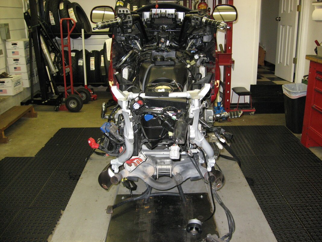

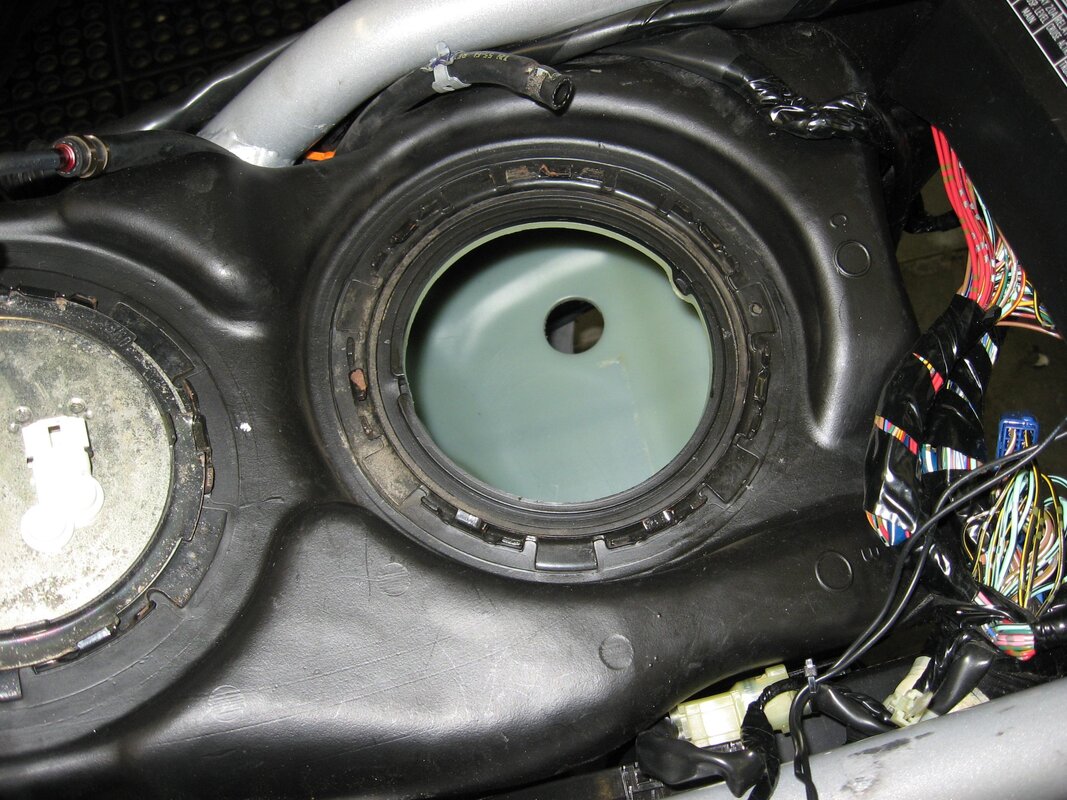

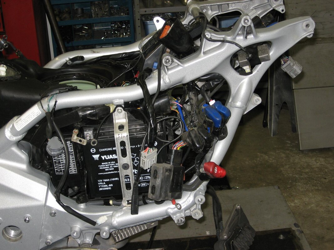

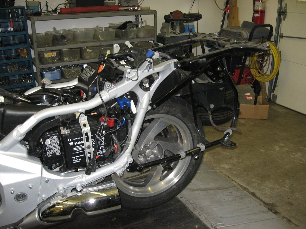

The next pics focus on tearing down the rear of the bike and prepping for the rear tire removal. The saddlebags and trunk have been removed. Gary is getting ready for the installation of the auxiliary fuel tank, installation of the chassis and wiring.
The front end is now fully buttoned up. The fork brace with dust cover is installed. The new lower front chrome cowel is installed.
Next up: Finishing the rear end.

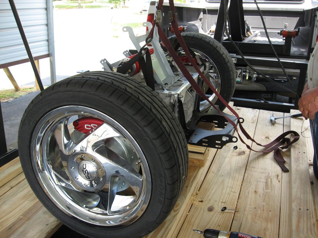

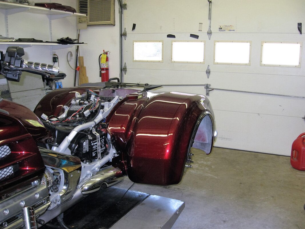

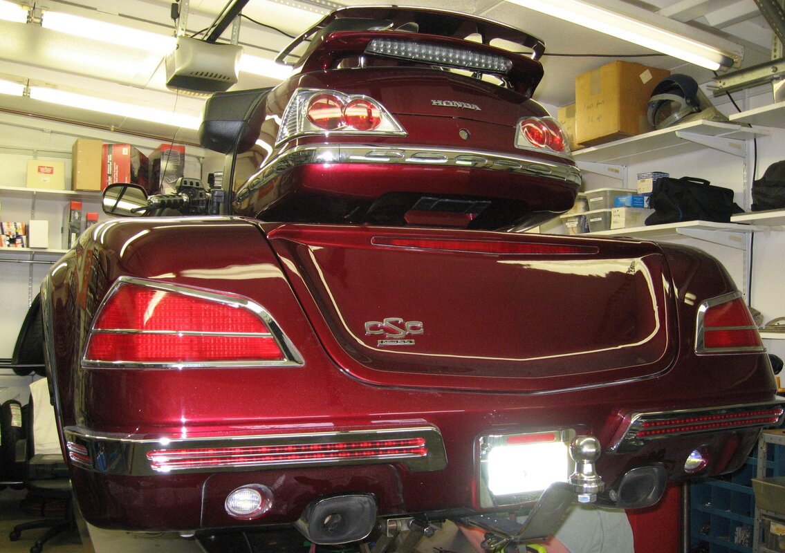

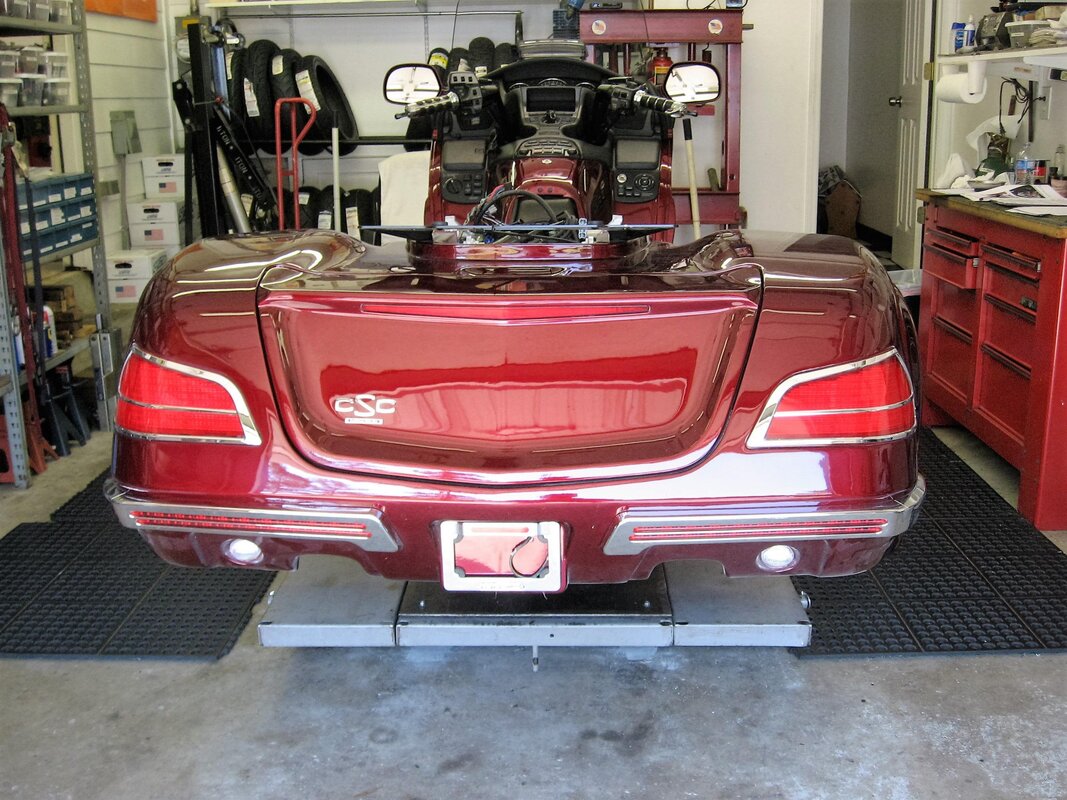

The conversion kit is now going through the final build stages prior to installation of the "Trike Body" and "Ground Effects".
The next (2) pictures show the installation of the intermediate mount plate. There is a bracket on the opposite side of this plate that supports the new home for the sound amplification system. Electrical connections are near completion. It is now easy to see the full structural integrity of the entire chassis.
In the next picture, Gary begins preparations for installation of the body. He first sorts out the body hardware, supplied with the kit, into individual trays that are clearly identified. This method makes sure all hardware inventory is installed and nothing is left out.
The next pic shows the "Ground Effects" placed out of the way from foot traffic and the build.
Now Gary will install the front fender, the left side "Ground Effect", the trike body and the tour box. Final electrical connections are made prior to "buttoning up".
Next , the exhaust tips, license plate and hitch are installed.

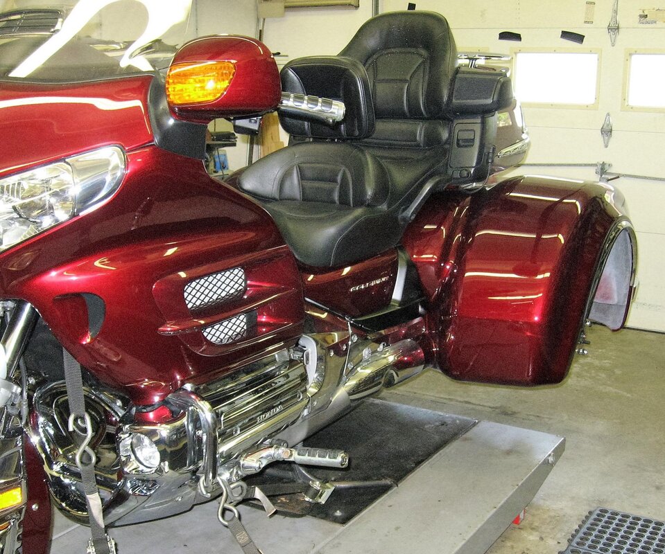

Next, the right side "Ground Effect" is installed. The chrome directional 17" wheels are installed. The body is now completed and ready for some chrome finishing touches.
The next two pictures are the trike's first touch down to the floor.

Allow me to back track a bit. I inadvertently left out of my previous post some important build pictures.:gah:
The following pics show the body being set and secured to the frame. The pics also show the reinstallation of the tour box.
We now have a completed trike body and frame. Gary is extremely careful by placing protective materials over finished bodywork areas while reinstalling the tour box.ThumbUp
