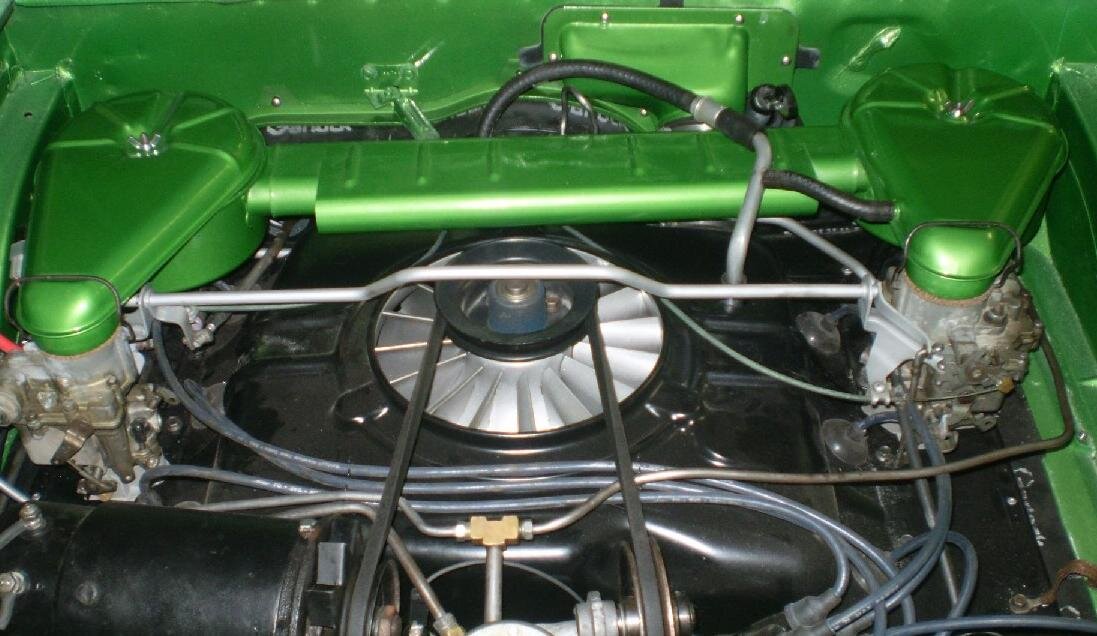

Mine has everything but the bottom tins. It's an open body, so airflow isn't an issue at most speeds. In fact, it probably runs too cold as it sits. I have a 72 row remote oil cooler with a 10" fan controlled by a 180 degree temp sensor. The fan rarely ever runs, unless it's very hot out and I'm running the guts out of it or riding in city traffic for long periods of time.
